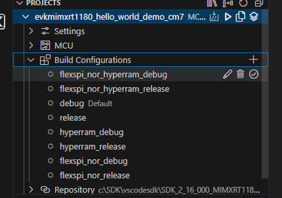

I was able to build the hello world app and when tried to deploy to 1189EVK, it does not work. The debugger starts up and shows as 'running'  and does not break at main() nor cannot be stopped. Console does not print anything.
I have tried flash erase via ".\LinkServer.exe flash MIMXRT1189xxxxx:MIMXRT1180-EVK erase", installing and re-installing mcu usb drivers , reinstalling mcuxpresso plugin etc.
Attached is the debugger log with engine logging.
What could I try next?

Hello @arunkumar_g,
Please try the following steps:
- Erase flash (right click on the project and select "Erase Flash"). Once the operation is completed it will show a message that it was successful.
- Flash the application (from QuickStart panel->Flash Programmer-> Select project-> Run)
- Debug (it may stop at reset handler; if yes, please issue continue command to reach "main")
Dragos.

Hi @arunkumar_g
Can this example work?
