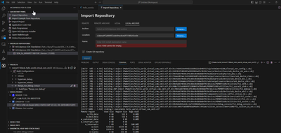

When building imported sample app rtos version of hello world cm33 vscode fails to build with error  "Error: Could not determine the build directory for project mimxrt1180evk_hello_world_demo_cm33". SDk is 2.15, board is 1180 rev B, The build does not even start.  Is there any logs to see what is happening?
When I tried a clean command (from vscode context menu) the log is
clean task started....
"C:\Program Files\CMake\bin\cmake.EXE" --build --config Debug --target clean --
Error: could not load cache
clean finished with error(s).
It seems that cmake tool does not get the path of project.  .vscode dir is attached. cmake is 3.28.1

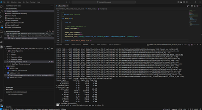

 I noticed from your files that you are using Windows. Windows has a limit for the length of the path (260 characters). So, if the path to where you created the project is long could you try to create it in a shorter path (like C:/work) and see if it helps?

 This is my test result:
Which VScode version you are using? I am using 1.87.0.
my cmake version is:cmake version 3.21.0
Your situation should caused by the repository import, which method you import the SDK?
I am also using the SDK2.15.0, do you use all Toolchians:
You can delete your vscode SDK, and import it again with the local method, whether it have improvement or not?

  If not use the vscode, use the IDE, eg, mcuxpresso, whether it works on your side?
  Just the Vscode version meet issues, right?
  I am also testing this code on my side, will give you updated information later.
Kerry
15,577 Views
arunkumar_g
Yes mcuxpresso works ok. VScode is the one that shows this error.
Note: both are in different machines.
