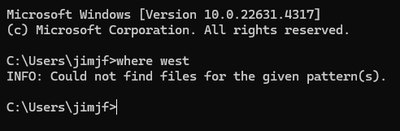

pcpro1789
@GeorgianaBoglis I discovered some artifacts in the MCUXpresso project files that were referencing an old project directory.  I fixed the artifacts, and now import of the MCU project seems to get farther along.  At least it shows me the error log now:
[2024-10-16T16:55:37.292] [proc] [info] Cmd: where python
[2024-10-16T16:55:37.312] [proc] [info] Cmd: C":\Program Files\SEGGER\JLink\JLinkGDBServerCL.exe" -listprobes USB
[2024-10-16T16:55:37.432] [proc] [info] Cmd: C:\Users\jimjf\AppData\Local\Microsoft\WindowsApps\python.exe --version
[2024-10-16T16:55:37.513] [proc] [info] Cmd: C:\Users\jimjf\AppData\Local\Microsoft\WindowsApps\python.exe -m west --version
[2024-10-16T16:55:37.597] [error] Could not read settings from mcuxpresso-tools.json for project "c:\Users\jimjf\repos\morpheus_firmware\imxrt685"
[2024-10-16T16:55:37.853] [proc] [error] C:\Users\jimjf\AppData\Local\Microsoft\WindowsApps\python.exe exited with code 1
C:\Users\jimjf\AppData\Local\Microsoft\WindowsApps\PythonSoftwareFoundation.Python.3.12_qbz5n2kfra8p0\python.exe: No module named west
[2024-10-16T16:55:37.857] [proc] [info] Cmd: where west.exe
[2024-10-16T16:55:37.893] [proc] [error] where exited with code 1
INFO: Could not find files for the given pattern(s).
[2024-10-16T16:55:37.894] [error] 'west' tool could not be found.
[2024-10-16T16:56:23.403] [proc] [info] Cmd: C:\NXP\MCUXpressoIDE_11.7.1_9221\ide\tools\bin\arm-none-eabi-gcc.exe --version
[2024-10-16T16:56:24.715] [converter] [info] Project converter: imxrt685: The 'Debug' build configuration will be excluded from conversion since the linker script file could not be found into the 'Debug' directory.
[2024-10-16T16:56:24.715] [error] Error: There are no valid build configurations for this MCUXpresso IDE project:  The 'Debug' build configuration will be excluded from conversion since the linker script file could not be found into the 'Debug' directory.
I'm still not sure what the "west" tool is supposed to be.

Joey_z
hi,pcpro1789
Can you check if west is installed at all (using the 'where' command on Windows):
C:\Users\erich>where west
C:\Users\erich\AppData\Local\Programs\Python\Python39\Scripts\west.exe
C:\Users\erich\AppData\Local\Microsoft\WindowsApps\west.exe
In addition, check if you successfully downloaded the SDK for the project.
I hope it can help you.

pcpro1789
@Joey_z The west tool does not appear to be installed on my system.
How do I install west?
I have the SDK (SDK_2_13_0_MIMXRT685S.zip).  It's installed in the MCUXpresso IDE.  How do I install it in MCUXpresso for VS Code?
3,708件の閲覧回数
cristiantepus
For installing a zip archive SDK: https://github.com/nxp-mcuxpresso/vscode-for-mcux/wiki/Working-with-MCUXpresso-SDK#import-standalone...
For installing west: install "MCUXpresso SDK Developer" component from MCUXpresso Installer
For downloading MCUXpresso Installer and reading more info about installing dependencies: https://github.com/nxp-mcuxpresso/vscode-for-mcux/wiki/Dependency-Installation
Note: Be aware that MCUXpresso Installer will provide you a west tool installation under a python virtual environment, it will not be added for the entire host OS (so it will not be installed for system python). This python virtual environment is created on ~/<your_user>/.mcuxpressotools/.venv
This "west" version will be used for further VS Code extension operations.
One direct effect of it: after creating a project in our extension, right click on a project -> Open in Integrated Terminal: this will automatically activate the venv so you'll be able to use west in command line:
Still, this is the default virtual environment we provide, if you have your own, read https://github.com/nxp-mcuxpresso/vscode-for-mcux/wiki/Settings#virtual-environment-setting
