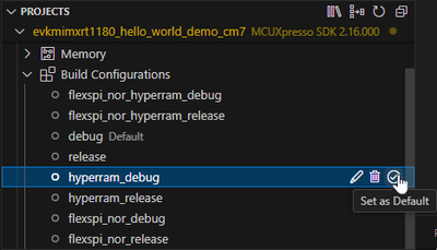

arunkumar_g
I have posted the query here https://github.com/nxp-mcuxpresso/vscode-for-mcux/issues/49
When building with new plugin and built via tool, it resets the cmake config to debug. I also noticed that adding custom buildPresets also doesn't because of this.
Note: I have also observed that after adding custom buildPresets, mcux_include.json just increases in size with many duplicate entries.

arunkumar_g
That made some progress. But the tool still fails to build with an additional build step. This is the error I see "Error: Could not find configuration: "[debug, evk-config]" in cmake presets configurations" - Please see attached file.
Also when I edit the toolchain in "evk-debug", the tool always resets it to default one ($env{SdkRootDirPath}/tools/cmake_toolchain_files/armgcc.cmake)

arunkumar_g
Our toolchain file wraps the default one, but adds some parameter and flag for compilation.
In case of build configs, as you can see from the attached preset file, I have added a new build config. This is a simplified version showing the problem.

EdwinHz
Hi @arunkumar_g,
This happens because the "debug" build is still selected as the default build configuration. Please select "hyperram_debug" as the default configuration under "MCUXpresso for VS Code" > Projects > Build Configurations:
Once selected as the default, building the project will not change the build configuration back to debug.
