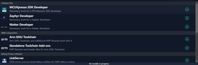

I want to try MCUXPresso for vscode
   Firstly, I use "MCUXpresso Installer" to install MCUXpresso SDK Developer、Zephyr Developer、Matter Developer、ARM GNU ToolChain、Standalone Toolchain Add-ons and all debug probes softwares successfully。
 Secondly, I create “SDK_25.03.00_FRDM-MCXN236” with all tool-chain
  Third, I install "MCUXPresso for vscode"  and install the sdk successfully, and I import a "hello world" demo,however,when I try to build the hello_world project,software output that
"arm-none-eabi-gcc.exe: fatal error: cannot execute 'cc1': CreateProcess: No such file or directory
compilation terminated.
ninja: build stopped: subcommand failed.
build finished with error(s). "
What‘s the problem of this?

Thanks for your reply. I have solved this problem by install the "ARM GNU Toolchain" Agian. Maybe I install the "ARM GNU Toolchain" failed in the last time.
Now I have another question, could you please help me ? The MCUpresso Installer just show intall function but do not show how to uninstall or update the toolchain,  so how uninstall or update the toolchain、developer such as "ARM GNU Toolchain"“MCUXpresso SDK Developer”“Zephyr Developer”  so on with the MCUpresso Installer.
