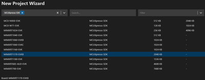

When I opened project Wizard I could see the following page:

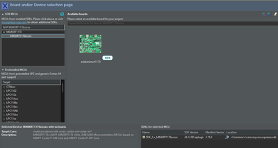

1. Is it possible to create project based not on EVK BOARD but on the microcontroller instead?
i.e. I'd like the new project to be dedicated for a microcontroller like I did in the "old" way in IDEmimlo_2-1747063592677.pngmimlo_2-1747063592677.png - It's a bit outdated SDK example
The reason I want to do it this way is to avoid any "bloat" modules/files, etc. that is not relevant for my microcontroller, since I have my own custom board. It has nothing to do with evaluation kit. Unless I have some wrong understanding about that SDK EVK/EVKB part and I should not worry about it.

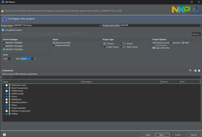

In MCUXpresso IDE I can do the following
After that, I can specify that I want the following project to have a role either of Standalone, MASTER or SLAVE
2. Since I do not see this option ATM, does it mean it's not yet supported (or never will be)?

Hi @mimlo,
1. Currently it is not possible to make a project based on a MCU SDK, since only the Board SDK are available.
2. I wouldn't be able to tell you whether this feature is going to be supported on the future.
3. Yes, I recommend you do that instead. Make sure to create the project and leave all of the files it is created with. Do not delete any of the files as this might result in missing dependencies.
