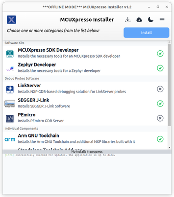

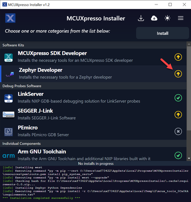

Are you certain that you installed the Zephyr Developer Software Kit when installing the MCUXpresso Visual Studio Installer? It is worth making sure that you are using the latest version of this, as well as updating the rest of the packages.
You can open the Installer window by selecting "Open Walkthrough" on the "Quickstart Panel" and clicking on the "Open Installer" button under "Check Tool Dependencies."

Kamison
Hey EdwinHz thanks for the answer. I checked the Installation and the installation lookes to be fine.
