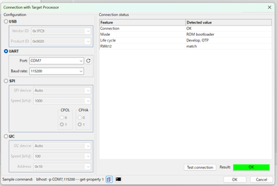

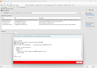

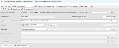

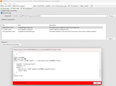

Following the instructions on the site below, I executed "Write Image,"
but it fails at the "Erase Flash" step, as shown in the attached image.
Could you please tell me how to resolve this?

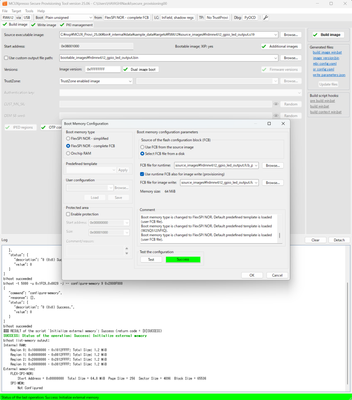

Build and Write completed with the following settings.

Hi @Nokhysh
can you go to main menu > Targets > Boot memory and open the memory configuration dialog and use "Test" button to verify the configuration is correct. On the screenshot I can see you are using FCB - are you sure the FCB contains configuration that matches your memory?
Marek

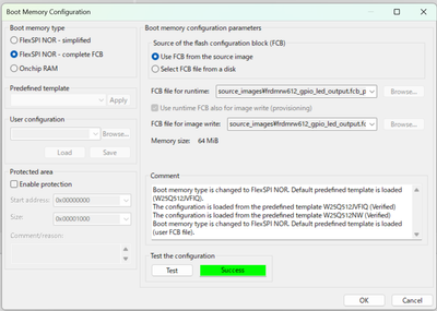

Nokhysh
こんにちは、  @marek-trmac
Thank you for your reply.
The test passes.
Based on the log below, I believe it matches the FCB memory size (64MiB).
Naoki.

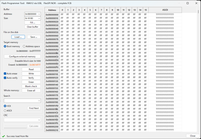

marek-trmac
Hi @Nokhysh
the "Test" button in the boot memory configuration verifies also read access to the memory. It seems you have read access. The problem might be in the write access.
If the original issue is still reproducible, I'd recommend to check write access. You can go to main menu > Tools > Flash programmer, configure the memory and try to write any block.
Also, based on the name of the FCB file on your screenshot, I suppose the FCB was taken from source image. Not sure what image you have, the FCB from the source image might not be properly configured for write. You can also consider using default tool configuration (simplified FCB). The default configuration was tested on FRDM board, and it should work.

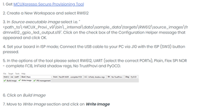

Nokhysh
Hi, @marek-trmac
I apologize for the misunderstanding.
The issue is unrelated to the file size; it fails during the "Erase Flash" process.
The method to reproduce the issue is in the attached procedure.
In step 7, when I try to "Write image," an error occurs during the "Erase Flash" process.
I would appreciate it if you could investigate this issue.
Naoki.

liborukropec
>>Where can I find the tool's default simplified FCB file?
There's no simplified FCB "file". If you want to use simplified configuration, simply select the first radio button in the "Boot Memory Configuration" dialog.
Libor

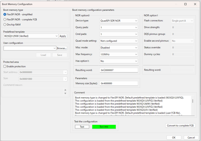

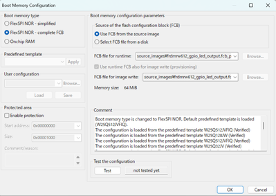

Nokhysh
Hi, @liborukropec @marek-trmac
I found the simplified FCB settings.
However, when I test with the attached FCB, it results in an error.
Naoki.

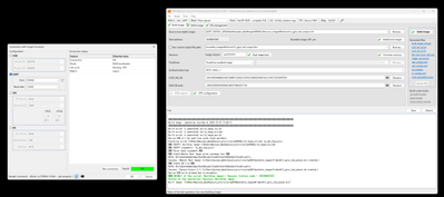

Nokhysh
Hi, @marek-trmac
Please see my answers to your questions below.
  • I am using Secure Provisioning Tool 25.06.
  • I have the FRDM-RW612 connected with two USB cables.
    However, since I needed to connect in ISP mode, I tried the connection method described in the following PDF: FRDM-RW612_ISP_and_Temperature_sensor_over_BLE.pdf.
  • With the default memory configuration(W25Q512JVFIQ), the "simplified Flex SPI NOR" option causes an error.
Naoki.

marek-trmac
Hi @Nokhysh
I tried today with SEC tool 25.06, MS Windows 11:
- connect FRDM-RW612 with two USB cables
- created new workspace for RW612
- main menu > Target > Boot Memory - Test: PASSED
- I used "C:\nxp\MCUX_Provi_25.06_final\bin\_internal\data\sample_data\targets\RW612\source_images\frdmrw612_gpio_led_output.s19" to build the image, I did not used FCB from the image
- Build + Write: PASSED
Summary: I did not reproduce any issue

Nokhysh
Hi, @marek-trmac
The test succeeds with the simplified FCB.
However, it fails to write, just like last time.
Naoki.

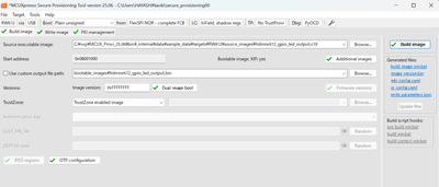

marek-trmac
Hi @Nokhysh ,
on your screenshot I can see you are using advanced (InField) life cycle. I'd recommend to use the basic use case until you are sure the memory configuration is valid.
In advanced life cycle, the ISP commands are limited. If you are using advanced life cycle, you need to do hard reset after every write command.
Also, I have already tested write with my board using simplified flash config and confirmed it works on my side. I have described step by step how to reproduce it. If it does not work on your side, I'd recommend to follow my steps or describe your steps. Otherwise, it is really difficult to understand, where the problem is on your side.

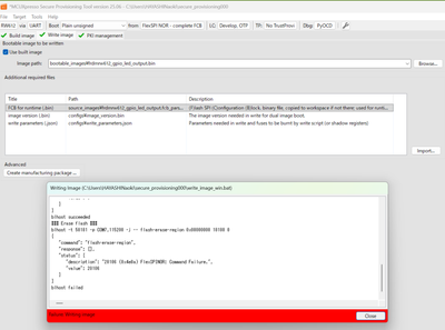

Nokhysh
Hi, @marek-trmac
I will summarize my procedure from the beginning.
  • Connected the RW612 with two USB cables.
  • Set the RW612 to ISP mode.
  • The connection test via UART was successful.
  • There were no issues building the attached image file.
  • There were no problems testing with the Boot Memory configuration of the completed FCB.
  • An error occurs during "Erase Flash" when writing.
I would appreciate it if you could point out any errors.
Naoki.

marek-trmac
Hi @Nokhysh ,
based on the latest screenshot, I can see you are using FCB taken from source image instead simplified configuration. Not sure what image you have, the FCB from the source image might not be properly configured for write. You can also consider using default tool configuration (simplified FCB). The default configuration was tested on FRDM board, and it should work.
I'd recommend to read the paragraph: User interface — MCUXpresso Secure Provisioning Tool 25.06 so you understand, what is the relationship between simplified configuration and full FCB configuration.
Marek

Nokhysh
Hi, @marek-trmac
I'm using a Flash Programmer Tool, and both the 'Write' and 'Erase' operations fail.
However, the 'Read' operation succeeds.
What could be the possible causes for this?"
Naoki.

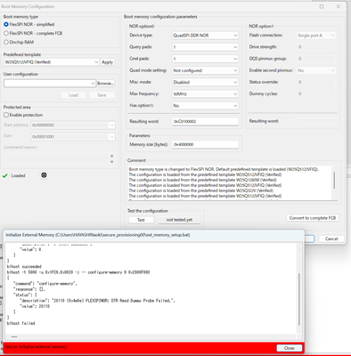

Nokhysh
Hi, @marek-trmac
A test was conducted using a simplified FCB and the boot memory configuration of the verified W25Q512JVFIQ(default), which resulted in a failure.
Naoki.
