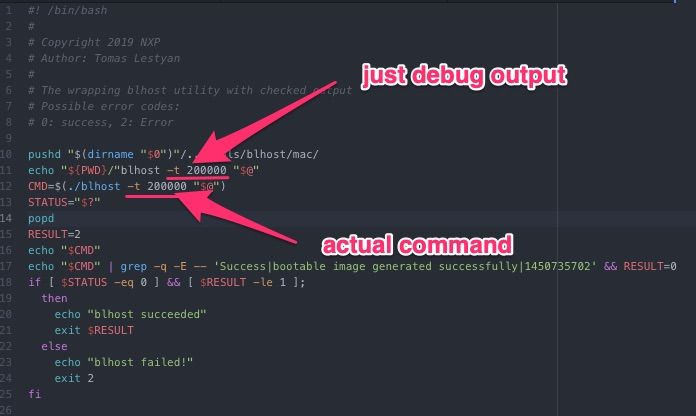

I am trying to write a generated bootable image to flash, but it fails with an error during the flash erase action.  I tried changing the wrapper script to blhost to add a timeout, but it still eventually failed.

/Applications/MCUX_Provi_v1/MCUXpresso Secure Provisioning Tools v1.app/Contents/MacOS/tools/blhost/mac/blhost -u 0x15A2,0x0073 -j -- flash-erase-region 0x60000000 774416 9
   "command" : "flash-erase-region",
   "response" : [],
   "status" : {
      "description" : "10004 (0x2714) No response packet from target device.",
      "value" : 10004
blhost failed!

OK, I found a fix.   In the blhost wrapper script (for Mac), I had only added the timeout to the debug output echo command.   I added the timeout to the *actual* command and it is now successful.

Hi Jack,
thanks for both question and correct answer. We will include the fix of timeout problem in next version of MCUXpresso Secure Provisioning Tool.
