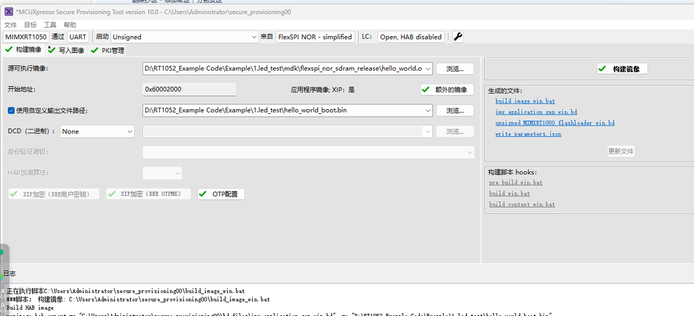

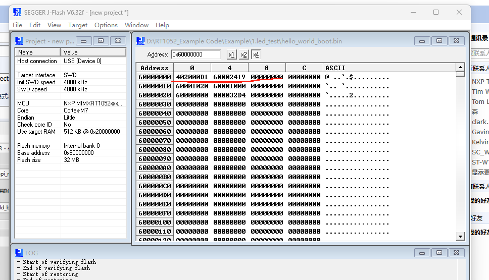

The image generated by the provisioning tool does not match, I did not see "FCFB

生成构建脚本: build_image_lnx.sh
生成构建脚本: build_image_win.bat
生成构建脚本: build_image_mac.sh
正在执行脚本C:\Users\Administrator\secure_provisioning00\build_image_win.bat
###脚本: 构建镜像: C:\Users\Administrator\secure_provisioning00\build_image_win.bat
Build HAB image
nxpimage hab export -c "C:\Users\Administrator\secure_provisioning00\bd_files\imx_application_gen_win.bd"  -o "D:\RT1052_Example Code\Example\1.led_test\hello_world_boot.bin"  "C:\Users\Administrator\secure_provisioning00\source_images\hello_world.srec"
Success. (HAB container: D:\RT1052_Example Code\Example\1.led_test\hello_world_boot.bin created.)
nxpimage succeeded
### Build flashloader as unsigned bootable image ###
nxpimage hab export -c "C:\Users\Administrator\secure_provisioning00\bd_files\unsigned_MIMXRT1050_flashloader_win.bd"  -o "C:\Users\Administrator\secure_provisioning00\bootable_images\unsigned_MIMXRT1050_flashloader.bin"  "C:\nxp\MCUX_Provi_v10\bin\_internal\data\targets\MIMXRT1050\flashloader.srec"
Success. (HAB container: C:\Users\Administrator\secure_provisioning00\bootable_images\unsigned_MIMXRT1050_flashloader.bin created.)
nxpimage succeeded
###脚本“构建镜像”的结果: 成功(返回代码= [0]成功)
操作的状态: 成功: 构建镜像

in your screenshot I can see the file name has "SDRAM" in it, but also in the screenshot the DCD is not configured, it might be the root cause why the application does not run.

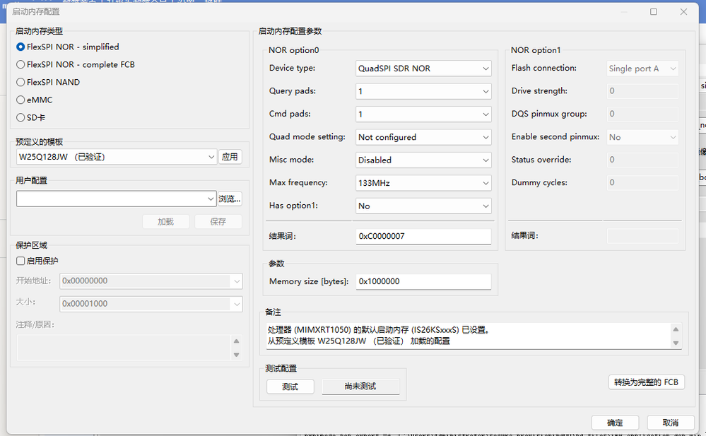

Hi, MCUXpresso Secure Provisioning tool does not generate the image with FCB, the FCB is written to flash as extra step. The FCB can be specified either as simplified or full configuration.
Kindly review generated write script for details.
Marek

Can't I run the LED program even after writing it in PROVISION TOOL? The image construction is incorrect. I can run it using KEIL's original image. Is it not possible to follow the official manual step by step? The documentation for this tool is not detailed enough. I can't use it.

Indeed, this issue has been resolved. thank you.
