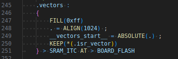

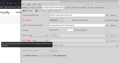

SPT seems to misdetect the entry point of one of my elf

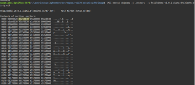

the popup reports 0x0000 as the entry point while readelf correctly detects it at 0x30002101
even exporting the binary data from the .vector section I find the right entry point
The doubt I have is that my .vector section will have to reside in ITC (VMA 0x0000) and has LMA 0x300508c4
in linker script:
If this was the problem how can I deal with it?

I tried placing the .vector section in flash (at 0x30002000), modifying the linker script. By doing this, SPT 8 no longer detects problems. However we have to have the .vectors section in ITC for application needs, so I guess this must be considered a bug. Besides, SPT 7 and SPT 6 have always worked correctly with my elfs.

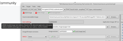

I did a quick test and I can see the same error in v8 and no error for the "upcoming" version.
I don't know how you can say that with the “upcoming” version it works for you.
I tried SPT9 with the file I attached in the first post and the result is identical to SPT8:
I remind you again that with STP7 this same file worked, which is why I consider this bug a regression,

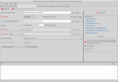

Hi @liborukropec
Image is parsed, but the `XIP` is not detected as in compare to v7
it seems clear to me that if I use SPT it is to get a working image. My micro has both XIP and HAB enabled.
And SPT9 misinterprets the elf and “thinks” that it should be run from external RAM (exactly as SPT8 did)
regards
