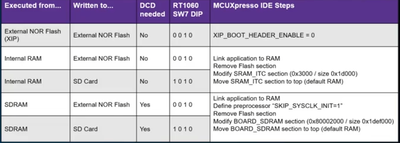

After Watching the guide video from https://www.nxp.com/design/design-center/training/TIP-MCUXPRESSO-SECURE-PROVISIONING-TOOL
In the last Scene,  I Can see below  table.

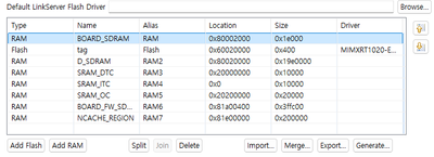

and,   I want  SDRAM executing     written to  External Nor Flash.
so,    Link application RAM,   SKIP_SYSCLK_INIT=1,  Remove Flash section  and modify BOARD_SDRAM section.
Seongyon_Jeong_1-1752047617364.pngSeongyon_Jeong_1-1752047617364.pngSeongyon_Jeong_2-1752047636011.pngSeongyon_Jeong_2-1752047636011.png
But  I cannot  Build  image , because of   [from] [xxxxxxx]
this toolbar position always  appear  RED.
only if  SDCARD and NAND,  It is Green.
How Can I  select this option  to   FLexSPI NOR - simplified or complete FCB ??
