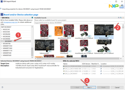

  • In the MCUXpresso IDE Quickstart panel click on “Import SDK example(s)…”
  • Select the MCXN947 , then select frdmmcxn947 board. Press then Next.
  • Expand the demo_apps tab, select the “led_blinky_peripheral_cm33_core0” and press Finish button.

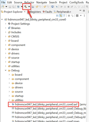

  • Build the project, you will see the binary file plus debug extensions
         “frdmmcxn947_led_blinky_peripheral_cm33_core0.axf”

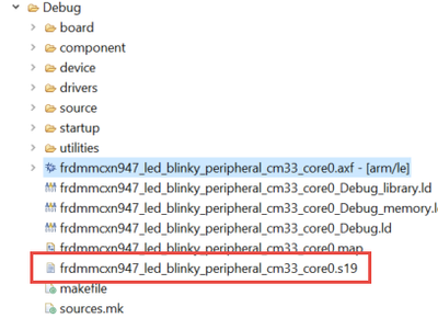

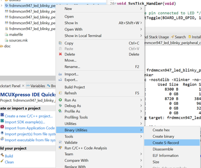

  • Right click on the above file and from the context menu select Binary Utilities and click on the Create S-Record option (as per the picture below). This will create a binary file with extension .s19:
Now we have the .s19file

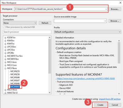

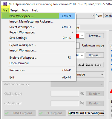

  • Create a new workspace clicking on File -> New Workspace option in the toolbar (or Ctrl+N).
  • Enter a folder name and configure the workspace as follows:
  • Enter workspace folder name.
  • Select MCXN947.
  • Click Create button to create.

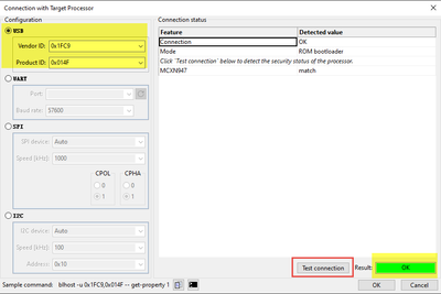

Use SPT tool test whether can connect with ISP mode. Click Target-> Connections…
The USB port will be automatically recognized. Then, click the "Test connection" button. If the result shows "OK", it means the connection is good.

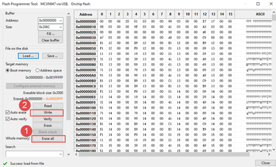

  • Open the Flash Programmer view through Tools->Flash Programmer
  •  Load the image to Flash Programmer tool as below:
  •  Erase flash and Write the image.
Reset board, blinky demo start to run.
