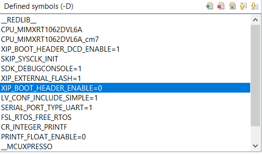

I'm struggling with download of the GUI examples from SDK 2.7.1 (emWIN, ew_gui, crank_storyboard and littlevgl) when using the Secure provisioning tool.
If I use a Segger JLINK or the on-board CMSIS-DAP with MCUXpresso debugger then everything is ok and the applications are executing as they should.
Building and writing the images with the Secure Provisioning Tool conclude without errors however the sw doesn't start and the display stays black. SW7 is set to boot from XiP serial NOR Flash. 0-0-1-0
Here my Preprocessor settings:
Is there any further modification necessary or did I miss anything else?

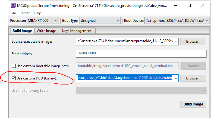

marek-trmac
Hi Guenter,
it seems the examples uses SDRAM. Try to add initialization of the SDRAM using DCD. You can use DCD file distributed within the Provisioning Tools, e.g.
If this helps, kindly mark the answer "Helpful"
Marek

guenter_loettrich
Hi Marek,
indeed using the DCD file for SDRAM initialization helped for some of the demos. Thanks for the hint.
However when trying to use it for the
ew_gui_examples and crank_storyboard_examples
I get error messages from blhost and the image is not being written.
