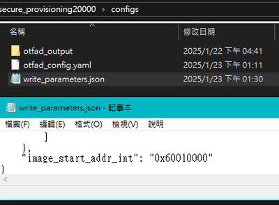

The main difference is in ..\configs\write_parameters.json.
However, even after modifying the differences, the issue remains unresolved.
Both work environments use the same project (evkmimxrt1010_flexspi_nor_polling_transfer), with the only difference on image start address (0x60010000 & 0x60020000).

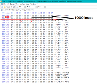

STEP 2:
Apply the .s19 file with the starting address 0x60010000 to the secure_provisioning20000 build_image_win.bat.
Apply the .s19 file with the starting address 0x60020000 to the secure_provisioning10000 build_image_win.bat.
The generated bootable images all have misplaced issues.
