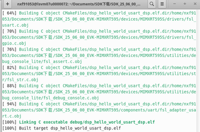

Hi @Nicolas-ph ,
I did the same test for you on a test environment and the problem should be in the environment variable configuration. Modify it to the following configuration and it will work:
XTENSA_SYSTEM=~/xtensa/XtDevTools/install/builds/RI-2023.11-linux/nxp_rt500_RI23_11_newlib/config
export XTENSA_CORE=nxp_rt500_RI23_11_newlib export
Gavin

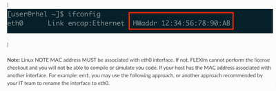

Gavin_Jia
Hi @Nicolas-ph ,
Thanks for your interest in NXP MIMXRT series!
The Windows environment can compile DSP code, so your configuration process should be fine. I just suspect that it could be due to a problem with the license in a Linux environment.
Gavin
