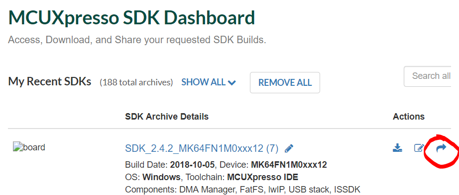

Hi GReg,
In order to ensure that someone gets the exactly same SDK configuration as you have, you can share a link to your SDK configuration with that person. Click the share action icon on your SDK entry on the MCUXpresso website dashboard page to get the link.

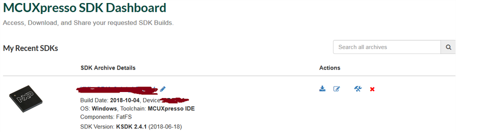

grzegorzkonopko
Hi Petr
I am looking "share" icon, but can not find, could you attach screenshot?
/Greg
2,136 Views
grzegorzkonopko
No such icon on my dashboard..

PetrKraus
Hi Greg,
2,136 Views
