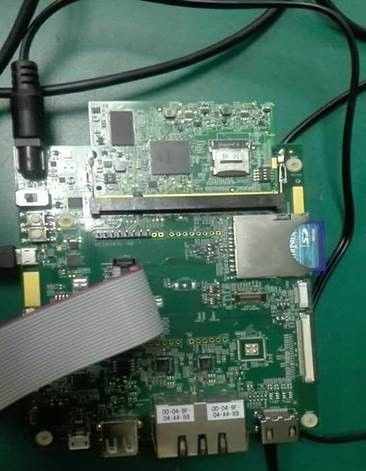

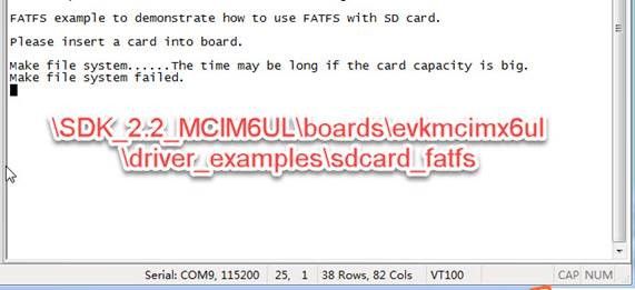

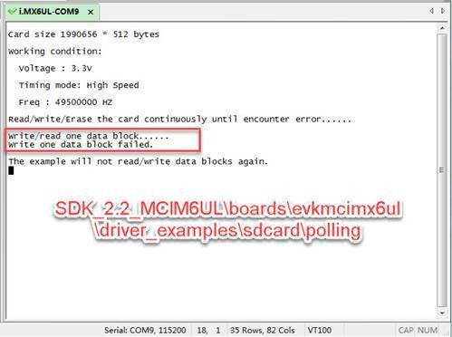

Hi:
on SDK_2.2_MCIM6UL, the example project for SD CARD always failed, the test is implememted on i.MX6 UL EVK, the snapshot is as below, please help check. thanks.

I've not been able to reproduce the issue so far. Check that your card is not write-protected.

Hi Artur:
I have get proper answer from some resource, seem some 2G card have such issue.
the patch could solve the issue, and will be add in next release. thansk
