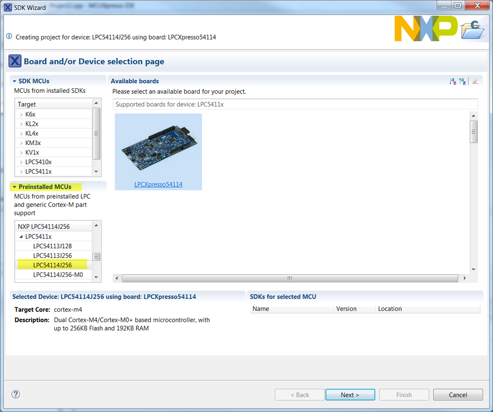

for test purpose i imported the "C" hello world sdk demo app for the lpc54114 sdk 2.2.1 and everything seems to work ... it prints "hello world and somehow also echoes input strings
since this is a "C" project and i need a "C++" framework i was really not into converting it into "C++" because of all the clumsy C-compiler and C-linker settings transfer into the C++ equivalents and a bunch more ... did it successful with the lpcopen uart sample
so, i tried to create a brand new mcuxpresso sdk based project and only changed the project type from "C" compiler setting to "C++" and included all drivers, otherwise i left the defaults ... it created ... it compiles to a size of, see below :
text data bss dec hex filename
200 0 8220 8420 20e4 lpc54114_sdk_main.axf
furthermore the startup directory is empty and no startup_lpc5411x.c  / cpp file can be found
am i doing something wrong ...  i thought i followed the following tutorial as much as possible

Building target: lpc54114_sdk_main.axf
Invoking: MCU C++ Linker
arm-none-eabi-c++ -nostdlib -L"/usr/local/e_drive/Baja/code-arm/cortex_54114/lpc54114_sdk_main/libs" -Xlinker -Map="lpc54114_sdk_main.map" -Xlinker --gc-sections -Xlinker -print-memory-usage -mcpu=cortex-m4 -mfpu=fpv4-sp-d16 -mfloat-abi=hard -mthumb -T lpc54114_sdk_main_Debug.ld -o "lpc54114_sdk_main.axf" ./utilities/fsl_debug_console.o ./source/board.o ./source/clock_config.o ./source/lpc54114_sdk_main.o ./source/pin_mux.o ./drivers/fsl_adc.o ./drivers/fsl_clock.o ./drivers/fsl_common.o ./drivers/fsl_crc.o ./drivers/fsl_ctimer.o ./drivers/fsl_dma.o ./drivers/fsl_dmic.o ./drivers/fsl_dmic_dma.o ./drivers/fsl_flashiap.o ./drivers/fsl_flexcomm.o ./drivers/fsl_fmeas.o ./drivers/fsl_gint.o ./drivers/fsl_gpio.o ./drivers/fsl_i2c.o ./drivers/fsl_i2c_dma.o ./drivers/fsl_i2s.o ./drivers/fsl_i2s_dma.o ./drivers/fsl_inputmux.o ./drivers/fsl_mrt.o ./drivers/fsl_pint.o ./drivers/fsl_power.o ./drivers/fsl_reset.o ./drivers/fsl_rtc.o ./drivers/fsl_sctimer.o ./drivers/fsl_spi.o ./drivers/fsl_spi_dma.o ./drivers/fsl_usart.o ./drivers/fsl_usart_dma.o ./drivers/fsl_utick.o ./drivers/fsl_wwdt.o ./CMSIS/system_LPC54114_cm4.o -lfsl_power_cm4_hard
Memory region Used Size Region Size %age Used
PROGRAM_FLASH: 200 B 256 KB 0.08%
SRAM1: 8220 B 64 KB 12.54%
SRAM0: 0 GB 64 KB 0.00%
SRAMX: 0 GB 32 KB 0.00%
SRAM2: 0 GB 32 KB 0.00%
/usr/mcuxpresso/mcuxpressoide-10.0.0_344/ide/tools/bin/../lib/gcc/arm-none-eabi/5.4.1/../../../../arm-none-eabi/bin/ld: warning: cannot find entry symbol ResetISR; defaulting to 00000000

Hi klausrschambeck,
The problem is that the SDK 2.2.1 package for the LPCXpresso54114 board does not come with a cpp startup file, that is why the project is generated without it. I have already reported this, as a workaround you can add the attached file to your cpp project.
Regarding the lpcopen project, you can create it without the need to remove the SDK package, just make sure that you select the LPC54114xxx MCU from the "Preinstalled MCUs" list instead of the "SDK MCUs" list:
Hope it helps!
