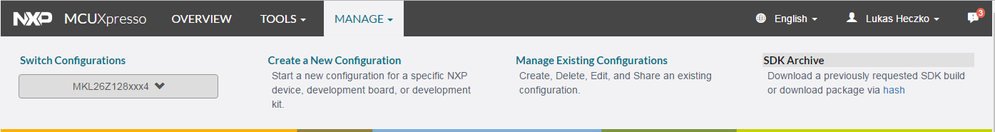

in MCUXPRESSO build for MKL26Z128VFT4 with selection FatFS, USB stack, FreeRTOS as middleware there is not USB stack. I am sure because I did same selection for KSDK 2.0.
In folder KSDK2.0/boards/frdmkl26z   there is usb_example folder (together with other folders)
in folder SDK_2.2_MKL26Z128xxx4/boards/frdmkl26z there is not usb_example folder (together with other folders).
1,447 Views
Lukas_Heczko
Hi Enore,

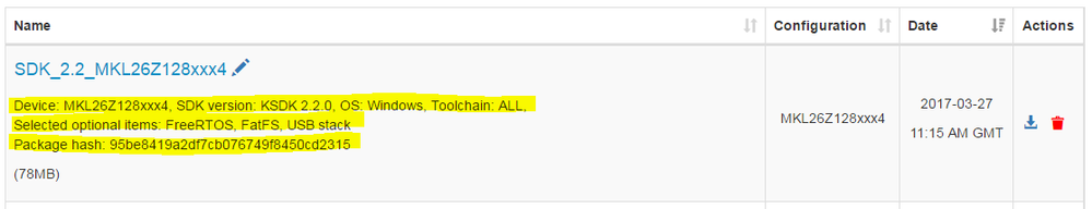

I tried to generate and download MKL26Z128xxx4 package and in boards\frdmkl26z I see usb_examples directory. Can you please share details about SDK configuration (including the Package hash) related to your SDK package? You can find it under MANAGE > SDK Archive:
Thank you,
