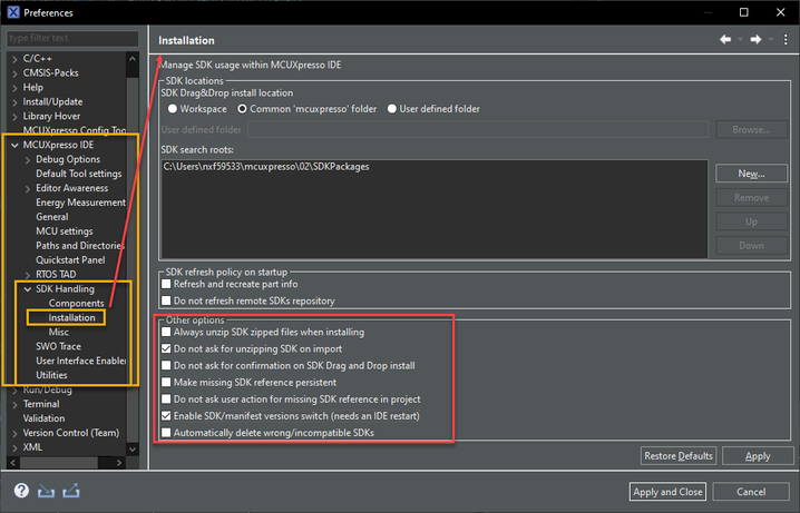

I am trying new SDK with new IDE , both v24.12.0, use RT1024-EVK, however, when i install new SDK, it overwrite the old v2.12.0, which is my current projects based on and works with v11.8 IDE, I wonder whether it is possible that my new IDE use a different SDK location, that is not interfere with existing SDK? I will update it when I am totally happy with new one.

Would be possible for you to try the Enable SDK/manifest versions swith option. You should  be able to install different versions of an SDK, when  this option is enabled.
If you are getting troubles to get the two versions , please report them to me,  along your OS. Please to reestart the MCUXpresso IDE, after enabling this option, a computer restart will do the job.
This option is under Preferences, please take a look at the below figure.

I have added my User defined folder, however, I could not remove the the Common folder SDK, I am intended to let one IDE use User defined folder, and another version use Common folder, however the User Defined one sees both. is that intended?

Could you detail more about this User Defined one sees both?  If  set my MCUXpresso IDE v24.12 [Build 148] [2025-01-10]  to User defined,  I will see that the SDKS from the common folder and my user defined folder are still available in the Installed SDKs window? Could you provide  a picture?

Here is the picture, it shows User Defined one - under o4 folder, which I created, also shows common one in folder ..02\SDKPackage although I didn't choose it.
In installed SDL Tab under IDE, it shows both too, I am using new IDEv24.12, BTW.
