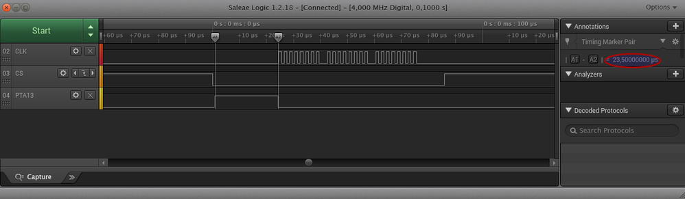

I'm trying to transmit some bytes through SPI as fast as possible. To do it I use DMA transfers with this setting:
  • MKL17Z running at 48MHz (Bus clock: 24MHz)
  • SDK v2.3.0
  • SPI: baud rate 1MHz and Slave Select as GPIO
With this configuration I'm able to see this timing.
After setting the Slave Select to Low state I immediately initiate a SPI_MasterTransferDMA call. Then I wait for the sending completion.
How can I do to improve -reduce- the time (18us) from the Slave Select to the first pulse of SPI clock?

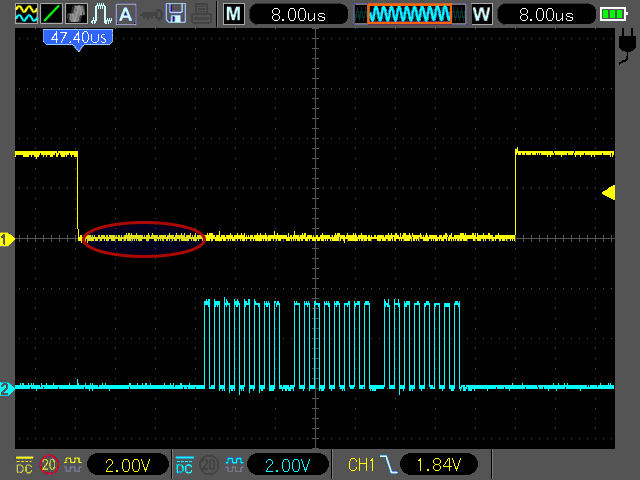

Yes indeed, in your code after the /CS falling edge the clock starts to run immediately. This is so in the case of a Slave Select Automatic Output configuration (default) where you can see one \CS cycle every sent byte. However, in my application I have to activate \CS and keep it in low state after sending the complete frame (3 bytes) as I've mentioned in the first post. To do it I've had to modify the code as follows:
Before the SPI initialization (SPI_MasterInit)
masterConfig.outputMode = kSPI_SlaveSelectAsGpio;‍
After SPI initialization I set PTC4 (/CS) as GPIO

Here's the captured frame using this settings:
Could you test this in your environment? I wonder  what is the reason for this time (~24us)?
regards,
gaston

xiangjun_rong
Hi, Gaston,
I think firmware executing time leads to the delay. If you set the SlaveSelectAutomaticOutput, the SPI master drives the /CS pin automatically by hardware, of course, there is no delay.
if you use GPIO mode, you clear the GPIO yourself, then call the SPI_MasterTransferDMA(), the delay time is the time the KL17 execute the api function SPI_MasterTransferDMA(), you can set another GPIO pin before the SPI_MasterTransferDMA() and clear the GPIO after SPI_MasterTransferDMA(), then compare the timing.
Hope it can help you
Xiangjun rong

gschelotto
Contributor V
Hi Xiangjun,
I've set PTA13 (blue LED in FRDM) instead PTB0. Indeed, the SPI_MasterTransferDMA()is the cause of the 23.5us delay.
