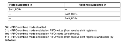

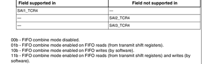

3) in the RxSetConfig, saiConfig->fifo.fifoCombine  *must* be set to 0b10 or 0b11, however, the enums for kSAI_FifoCombineModeEnabledOnRead is incorrect for the SAI4 RCR FCOMB, it is only correct for SAI1 TCR4 FCOMB.  So, you need to change the assert statement to be kSAI_FifoCombineModeEnabledOnWrite instead of kSAI_FifoCombineModeEnabledOnRead, for the RCR4 assert.
The mode we want  on TCR4 is mode 0b10, and the mode we want on RCR4 is mode 0b10.  So, we *always* want 0b10.
However, the enum is defined like this, which is correct ONLY for TCR4 mode.
typedef enum _sai_fifo_combine
    kSAI_FifoCombineDisabled = 0U, /*!< sai fifo combine mode disabled */
    kSAI_FifoCombineModeEnabledOnRead, /*!< sai fifo combine mode enabled on FIFO reads */
    kSAI_FifoCombineModeEnabledOnWrite, /*!< sai fifo combine mode enabled on FIFO write */
    kSAI_FifoCombineModeEnabledOnReadWrite, /*!< sai fifo combined mode enabled on FIFO read/writes */
} sai_fifo_combine_t;
So, we must change the fsl_sai_edma.c with the following change:
*** 439,441 ****
          (saiConfig->channelNums <= 1U) ||
!         ((saiConfig->channelNums > 1U) && ((saiConfig->fifo.fifoCombine == kSAI_FifoCombineModeEnabledOnWrite) || (saiConfig->fifo.fifoCombine == kSAI_FifoCombineModeEnabledOnReadWrite))));
--- 439,441 ----
!         ((saiConfig->channelNums > 1U) && ((saiConfig->fifo.fifoCombine == kSAI_FifoCombineModeEnabledOnRead) || (saiConfig->fifo.fifoCombine == kSAI_FifoCombineModeEnabledOnReadWrite))));
I have included a patch that fixes the issues.
