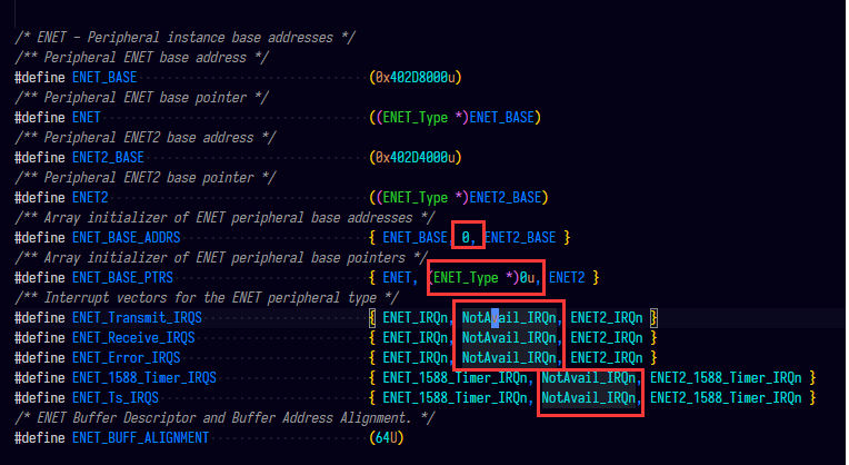

All the other array sizes are determine by macro's in MIMXRT1062.h:
/** Array initializer of ENET peripheral base addresses */
#define ENET_BASE_ADDRS { ENET_BASE, 0u, ENET2_BASE }
/** Array initializer of ENET peripheral base pointers */
#define ENET_BASE_PTRS { ENET, (ENET_Type *)0u, ENET2 }
/** Interrupt vectors for the ENET peripheral type */
#define ENET_Transmit_IRQS { ENET_IRQn, NotAvail_IRQn, ENET2_IRQn }
#define ENET_Receive_IRQS { ENET_IRQn, NotAvail_IRQn, ENET2_IRQn }
#define ENET_Error_IRQS { ENET_IRQn, NotAvail_IRQn, ENET2_IRQn }
#define ENET_1588_Timer_IRQS { ENET_1588_Timer_IRQn, NotAvail_IRQn, ENET2_1588_Timer_IRQn }
As you can see the macro expand to 3 elements while s_ENETHandle[] has only 2 elements. For some reason they left a gap between ENET and ENET2.

For now we got things working by setting FSL_FEATURE_SOC_ENET_COUNT to 3 but this is strange because the device has only 2 ENET's.

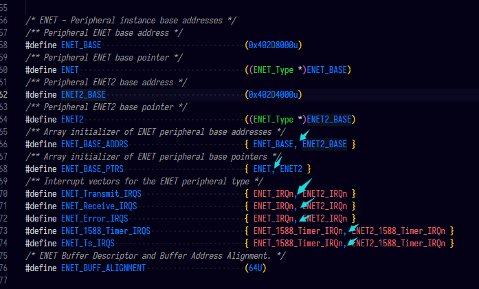

phantomgz
@danielchen
I have downloaded the current "SDK_2_12_0_MIMXRT1060-EVKB", but the same issue still exists.
After changing to this, I can active enet2.
Cai.

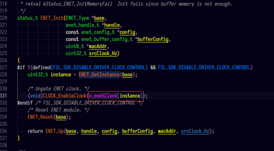

phantomgz
@danielchen
look at the calling chain from  ENET_Init()
ENET_GetInstance(ENET2) return 1,
s_enetClock[instance] return kCLOCK_IpInvalid,
CLOCK_EnableClock() run failed to init enet2 clock,
