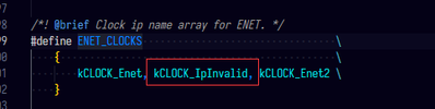

The fsl_enet drivers in the SDK for i.MX RT106x contain some array of data structures based on the number of ENET peripherals available. There is a mismatch in number of array elements which causes a HardFault when using ENET2.
Looking at fsl_enet.c, we see several arrays being declared:
/*! @brief Pointers to enet handles for each instance. */
static enet_handle_t *s_ENETHandle[FSL_FEATURE_SOC_ENET_COUNT] = {NULL};
/*! @brief Pointers to enet clocks for each instance. */
#if !(defined(FSL_SDK_DISABLE_DRIVER_CLOCK_CONTROL) && FSL_SDK_DISABLE_DRIVER_CLOCK_CONTROL)
const clock_ip_name_t s_enetClock[] = ENET_CLOCKS;
#endif /* FSL_SDK_DISABLE_DRIVER_CLOCK_CONTROL */
/*! @brief Pointers to enet transmit IRQ number for each instance. */
static const IRQn_Type s_enetTxIrqId[] = ENET_Transmit_IRQS;
/*! @brief Pointers to enet receive IRQ number for each instance. */
static const IRQn_Type s_enetRxIrqId[] = ENET_Receive_IRQS;
#if defined(ENET_ENHANCEDBUFFERDESCRIPTOR_MODE) && ENET_ENHANCEDBUFFERDESCRIPTOR_MODE
/*! @brief Pointers to enet timestamp IRQ number for each instance. */
static const IRQn_Type s_enetTsIrqId[] = ENET_1588_Timer_IRQS;
#endif /* ENET_ENHANCEDBUFFERDESCRIPTOR_MODE */
/*! @brief Pointers to enet error IRQ number for each instance. */
static const IRQn_Type s_enetErrIrqId[] = ENET_Error_IRQS;
/*! @brief Pointers to enet bases for each instance. */
static ENET_Type *const s_enetBases[] = ENET_BASE_PTRS;
The s_ENETHandle[] array size is determined by FSL_FEATURE_SOC_ENET_COUNT defined in MIMXRT1062_features.h:
/* @brief ENET availability on the SoC. */
#define FSL_FEATURE_SOC_ENET_COUNT (2)
All the other array sizes are determine by macro's in MIMXRT1062.h:
/** Array initializer of ENET peripheral base addresses */
#define ENET_BASE_ADDRS { ENET_BASE, 0u, ENET2_BASE }
/** Array initializer of ENET peripheral base pointers */
#define ENET_BASE_PTRS { ENET, (ENET_Type *)0u, ENET2 }
/** Interrupt vectors for the ENET peripheral type */
#define ENET_Transmit_IRQS { ENET_IRQn, NotAvail_IRQn, ENET2_IRQn }
#define ENET_Receive_IRQS { ENET_IRQn, NotAvail_IRQn, ENET2_IRQn }
#define ENET_Error_IRQS { ENET_IRQn, NotAvail_IRQn, ENET2_IRQn }
#define ENET_1588_Timer_IRQS { ENET_1588_Timer_IRQn, NotAvail_IRQn, ENET2_1588_Timer_IRQn }
As you can see the macro expand to 3 elements while s_ENETHandle[] has only 2 elements. For some reason they left a gap between ENET and ENET2.
At several places in fsl_enet.c the function ENET_GetInstance(base) is used to determine the index for one of the arrays above. Because this function iterates through s_enetBases[], the returned index can be 0 to 2 (because there are three elements).  All arrays can be accesses this way except for s_ENETHandle[] but this is done in several places in fsl_enet.c. For instance in ENET_SetHandler():
static void ENET_SetHandler(ENET_Type *base,
      enet_handle_t *handle,
      const enet_config_t *config,
      const enet_buffer_config_t *bufferConfig)
   uint8_t count;
   uint32_t instance = ENET_GetInstance(base);
   <removed part for clarity
   /* Save the handle pointer in the global variables. */
   s_ENETHandle[instance] = handle;
As you can imagine, things can go horribly wrong this way.
For now we got things working by setting FSL_FEATURE_SOC_ENET_COUNT to 3 but this is strange because the device has only 2 ENET's.

theory, there is another issue in ethernetif1_init(), if I modified the
ENET_BASE_ADDRS and ENET_BASE_PTRS
4,693件の閲覧回数
phantomgz
@danielchen
look at the calling chain from  ENET_Init()
ENET_GetInstance(ENET2) return 1,
s_enetClock[instance] return kCLOCK_IpInvalid,
CLOCK_EnableClock() run failed to init enet2 clock,
