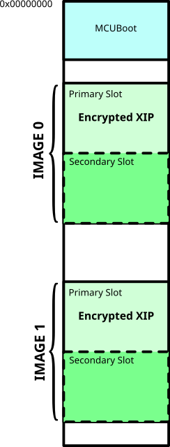

In the mcuboot sources, it is possible to find a bunch of files provided by NXP to deal with encrypted xip: SDK_25_06_00_EVK-MIMXRT1020/middleware/mcuboot_opensource/boot/nxp_mcux_sdk/encrypted_xip/
In my projects, I use RT117x, RT105x, and RT102x, so I deal with BEE and OTFAD peripherals.
I searched for documentation and examples for these files, for example here https://mcuxpresso.nxp.com/mcuxsdk/latest/html/middleware/mcuboot_opensource/README.html# but I didn't find what I was looking for.
I need to know:
  • features
  • usage examples
  • API reference
My use case is as follows:
  • Image 0 is a second stage bootloader. It implement the USB host mass storage stack, which is the only way to update the device.
  • Image 1 is the actual application.
I believe that both images need to be encrypted, but I am not certain.
Can you tell me where to find a reference design that uses these sources?

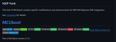

Furthermore, having two images, I need mcuboot 2.2.0 (2.1.0 does not work with multiple images).
Version 2.1.0 is integrated into the last SDK, as indicated here:
best regards
Max

Hi @mastupristi
I am sorry for the delayed response.
As an alternative solution, at this moment , we  have our SBL, which is based on the MCUboot, enabling encrypted XIP. However it is based on an older version of the MCUBoot.
I have been checking internally, and I the SDK team said that the SDK now integrates latest version of the MCUboot.
Basically you want to have addittional information covering :
  • features
  • usage examples
  • API reference
but for encrypted application correct? Can we say that an example about using on-chip OTFAD in conjunction with MCUBoot  could work at this moment for you?
Diego
