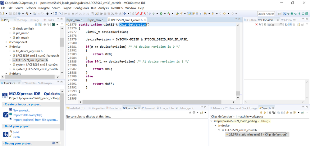

Hi, I just downloaded latest latest SDK 'SDK_2.6.3_LPC55S69', now when I use pin config tool to autogenerate pin_mux.c etc. I get build error...
>>>  ../board/pin_mux.c:202: undefined reference to `Chip_GetVersion'
The autogenerated file pin_mux.c has added some extra code like this, which fails to compile...
    if (Chip_GetVersion()==1)
<snip>
Any idea what I need to do to get it working?
Jon

Hi, Jon,
Regarding your question, pls refer to the screenshot, the Chip_GetVersion() function is located at LPC55S69_cm33_core0.h. Pls add the line
#include "LPC55S69_cm33_core0.h"
in this way, the compiler can get the function.
BTW, I use SDK_2.6.3_LPCXpresso55S69.zip package.
Hope it can help you
XiangJun Rong

Hi XiangJun,
I found the proper way to resolve this issue.
First thing to note is that my file 'LPC55S69_cm33_core0.h' had no such function of `Chip_GetVersion'.
It seems that after installing new SDK, existing project doesn't automatically use the new SDK.
In "Installed SDKs" view, need to 'uncheck' older SDK, then opening existing project will prompt to switch to new SDK. This will refresh SDK components including updating the file of  'LPC55S69_cm33_core0.h'
Now code will build ok with no change needed to pin_config.c
Jon
