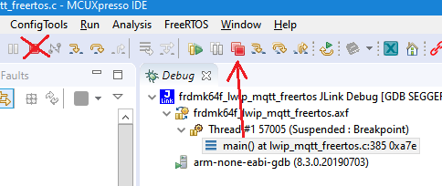

I'm trying to single step in a debug session with the frdmk64f_lwip_mqtt_freertos SDK example project but it is not possible. I start the debug session and if I click Resume (F8) button the application runs just fine, I can see the application output in the terminal just fine. But if instead of running I click the Step Over (F6) or Step Into (F5), then the debugger doesn't do anything.
When pressing Step Over (F6), the Resume and Suspend icons gray out as if it was running but it just gets stuck, nothing happens. I have to end the debug session to get it out of this non-responsive state.

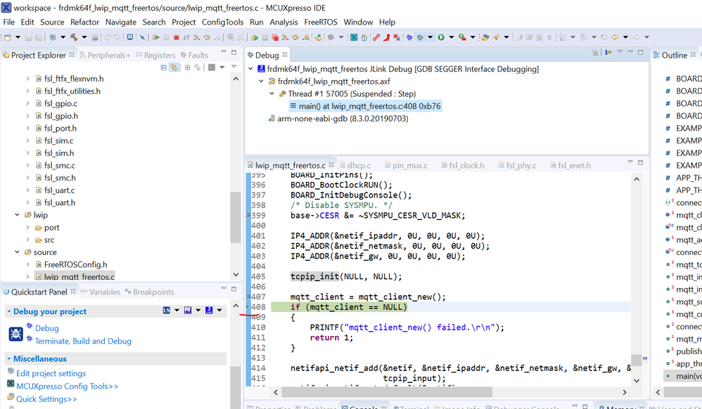

I have added the blinky and hello_world and both debug perfectly fine. I mean, I can single-step through the code.

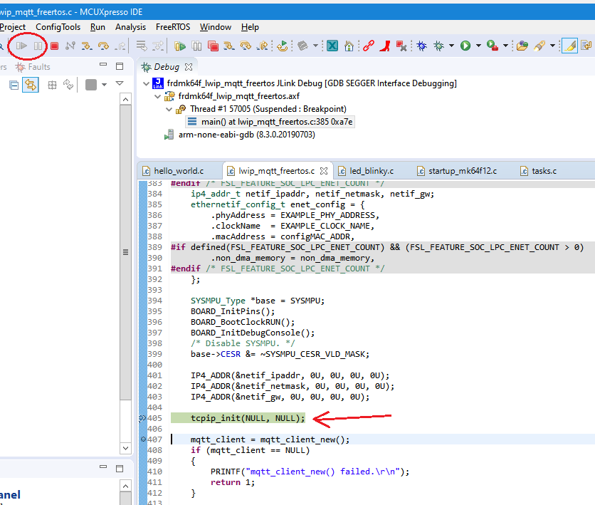

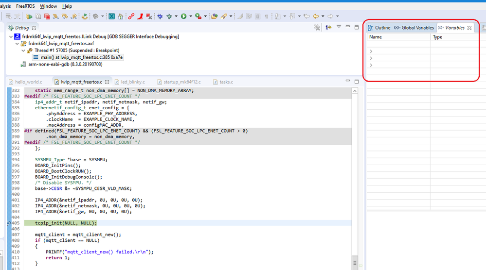

If I set a breakpoint and hit Resume (F8) the code runs up to the breakpoint, but it runs slower than it should. Also, the "Variables" window doesn't populate.
If I put a breakpoint on line 407 and hit Resume (F8), then the code doesn't respond anymore and gets stuck as if running but it never gets out of line 405.
To gain control again I have to click the Terminate ALL Debug Sessions instead of just the Terminate button as I would normally do (with blinky and hello_world for example).
It seems that the breakpoint technique only works once but then the code goes unresponsive when trying to resume execution.

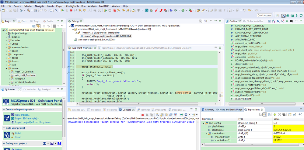

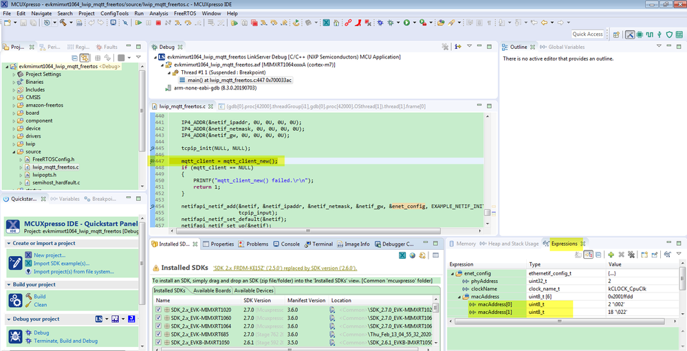

Hi Manuel Malagon,
   This is my test result on my MIMXRT1064-EVK board
You can find my breakpoints works OK.
You can use the Expression window to check the variable data.
My SDK version is 2.7.0
But My IDE version is MCUXpresso IDE v11.1.0 [Build 3209] [2019-12-12]

You really need to test with Segger JLINK. I just tested with an ARM ULINK2 probe, inspired by your screenshots, and debugging works perfectly fine, same project, the same tool, same configurations, same everything. The problem is with SEGGER JLink debugger.
I'm using a JLink Base so I don't think it is a restriction that could possibly be found in an EDU version.
