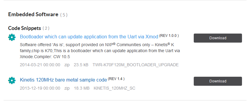

danielchen
Hi Ramil:
For bare metal code, please download it from below link
TWR-K70F120M|Tower System Board|Kinetis MCUs | NXP
For MQX, you can download it from below link. K70 is very similar to K61.
MQX™ Software Solutions - Releases and Patches | NXP
2,423 Views
