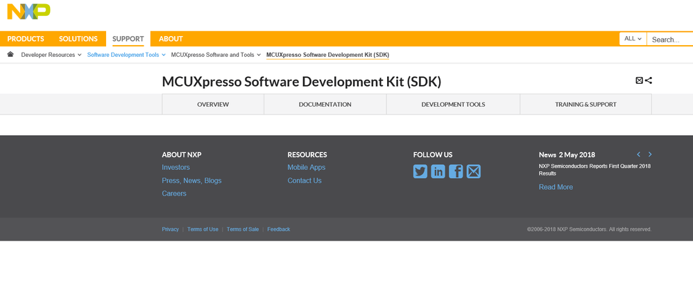

I am trying to start developing on a NXP smartphone quick-jack(LPC812).
But I can not find SDK.
When i clik the MCUxpresso sdk download, website is empty like below picture.
Where can I find SDK for NXP smartphone quick-jack(LPC812)?

Hi Kim,
You can find a software package named LPC812_Example_Code_Bundle_LPCXpresso_r1.00.00 inside your MCUXpresso IDE installation on this path C:\nxp\MCUXpressoIDE_10.1.1_606\ide\Examples\CodeBundles. You can use those drivers as base for your application.
Hope it helps!
