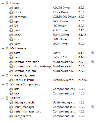

I am having an issue building a FRDM-K64F project with FreeRTOS, FatFS and sdmmc_host_sdhc support. When I create a new project with these three components included together, I cannot build the project and I get the error:
../component/osa/fsl_os_abstraction_bm.c:86:31: error: conflicting types for 'task_handler_t'
This happens even before I have added any code to the project. I am running SDK version 2.9.0 (and also had this issue with 2.8.1), MCUXpresso version 11.3.
Here are the SDK components I am using for the project:
Does anyone know what could be causing this issue?

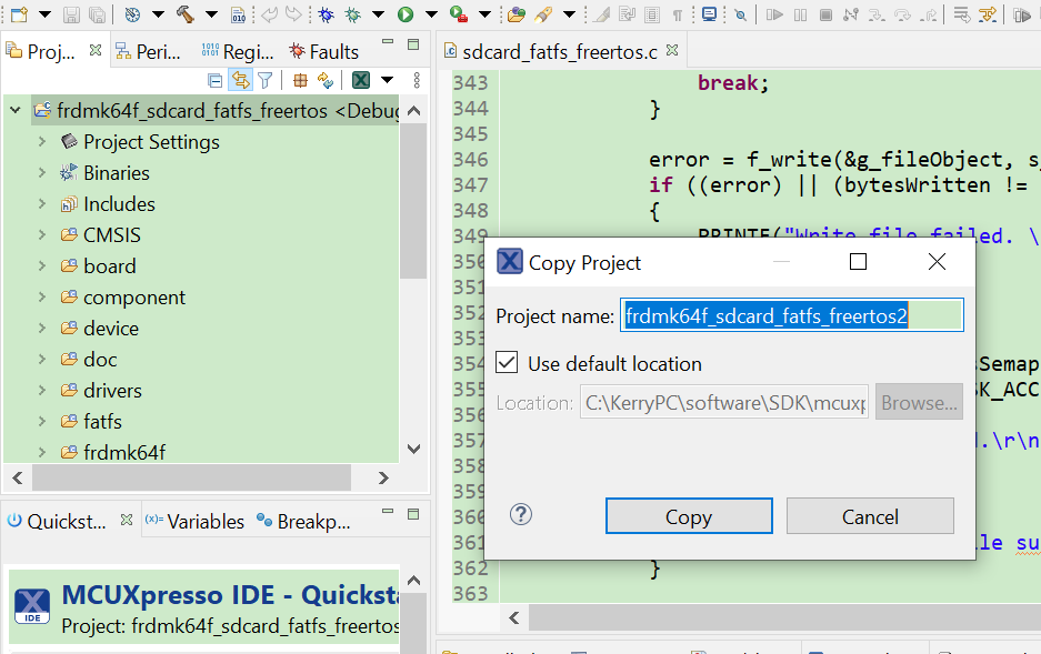

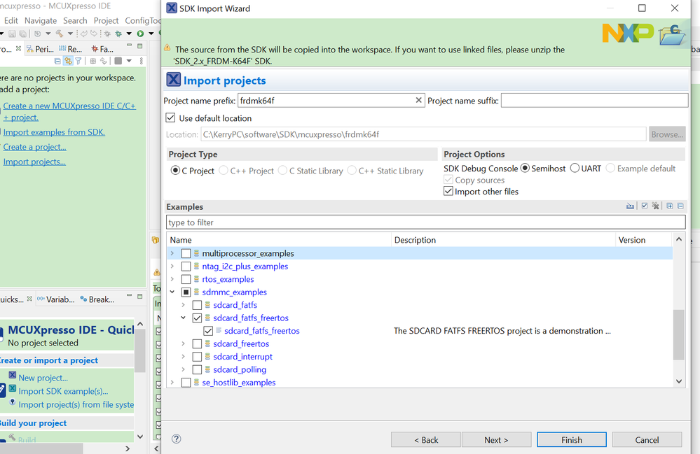

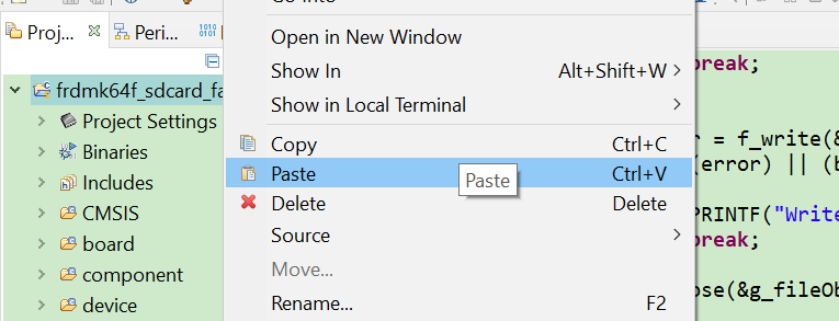

  When you import the frdmk64f_sdcard_fatfs_freertos project directly, do you have the build issues or not?
If no issues, you can import this project, the you can use the project right click, copy and past, to rename the project to your own project name, and do the modification based on that project:
Please try it on your side.

Thank you, I was able to get my project to build starting with the example.
