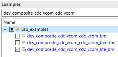

Pavel_Hernandez
Hello, my name is Pavel, and I will be supporting your case, I could not find the example "usb_device_composite_cdc_vcom_cdc_vcomon the SDK v2.16, could you confirm the name of this? I find the next.
