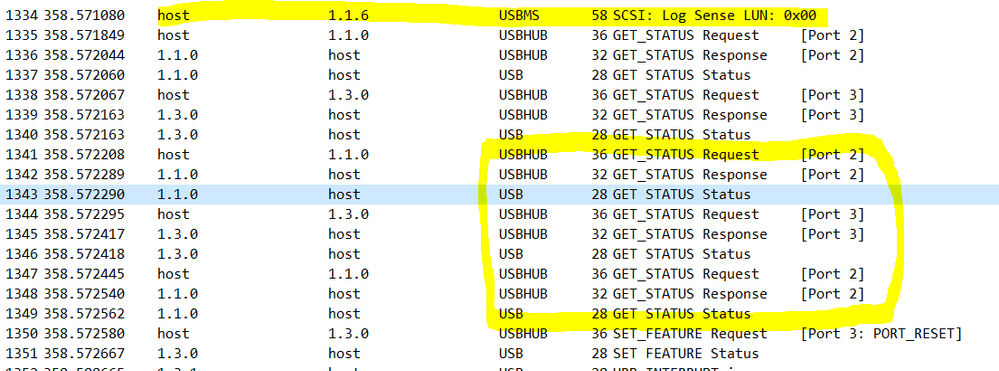

I uploaded the binary to my board and monitored the USB using Wireshark with USBPCap. I didn't connect to anything (VCOM) or played with the filesystem, I just let it run in "idle" mode.
I was able to track a Log Sense request in your application too.
Check the attached file (utasker.pcapng - usb.device_address == 1): after enumeration, I see several Test Unit Ready requests and the answers. After a while (req no. 934), there are two Read Capacity (10) requests, an Inquiry LUN and finally a Log Sense (which your application actually answers), followed by some URB_CONTROL frames and than it goes on.
I did the same in my application (file bruno.pcapng - usb.device_address == 1) and the same thing occurs (req. no. 1323), but I have more URB_CONTROL frames.
The answer of an unsupported command is what I would expect (according to the USB/UFI/SCSI doc), but it seems like it never gets to be sent:
  • Sense Key: 0x05 (UFI Illegal Request)
  • ASC: 0x20 (UFI Invalid Command Opcode)
  • ASQ: 0x00 (UFI No Sense)

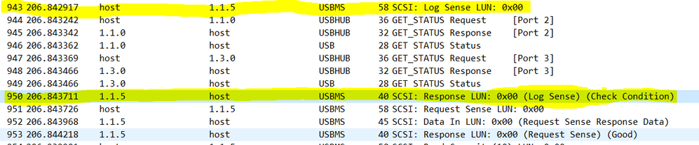

I don't know whether you can see everything with Wireshark but there is certainly a STALL taking place in the uTasker binary (although I don't get the log sense when I connect to my Win 10 machine I can still simulate it). Comparing the simulation result and the recording that you made:
The host sends the log sense in line 943.
I don't know how to interpret the lines 944..949 but I suspect it is showing a stall taking place and the stall being unstalled (although the unstall takes pace on endpoint 0 and I don't know whether this is filtered out or not).
950 is the termination of the process where the device is reporting that the previous command failed (the very last 1 in the data packet is the result - CSW_STATUS_COMMAND_FAILED, which is 1). This is exactly what I see when simulating the case and it is normal behavior for an unsupported command. Therefore the answer is "reporting the failure of the last request" and not actually handling it in any specific way.
Looking at your case:
It looks like the additional traffic is related to the stall process but I don't know how to interpret the content with Wireshark, or whether Wireshark really sees all details. I notice that there is a SET_FEATURE request following it and I suspect that what you are seeing is in fact the USB hub communication which is commanding it to perform a bus reset due to the previous activity causing an unrecoverable error.
My careful conclusion would be that you do have a problem with stalling which doesn't cause the host to wait (and timeout) but immediately declare a serious error and command a reset [maybe we are seeing it make two or three retries at something in the process]. There is a possibility that the actual error is the unstall part (eg. it is trying to unstall but not the correct endpoint that actually stalled - this would be my first point of investigation in fact).

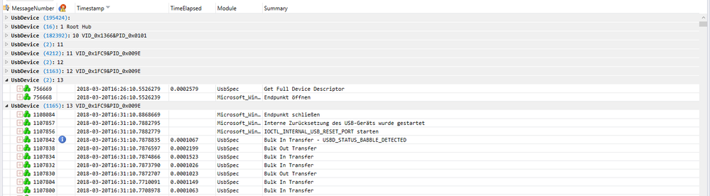

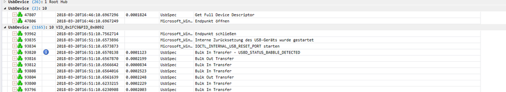

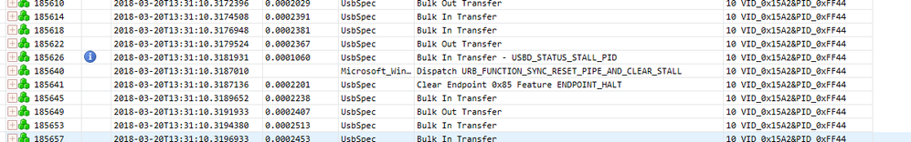

Hey Mark,
thanks for the tips. In Wireshark, the addresses (if I understood correctly) are formed as BUS.DEVICE.ENDPOINT. That menas 1.3.* and 1.1.* are different devices and from the pictures, I'd say the board is enumerated with the address 1.1.*.
Wireshark indeed doesn't show much of the communication and I unfortunately don't have a Hardware USB Analyzer. I found, though, another tool that gave me better results: Microsoft Message Analyzer. I redid the experiments with this tools and got the following results:
My firmware
During enumeration, I get some problematic packages (6 packages). They show problems with Stall commands followed by endpoint halt command, but enumeration goes fine.
After enumeration, communication goes on as it was on the Wireshark experiments (several Bulk In and Bulk Out Transfers), until eventually I get the following error: Status Babble. This makes windows close the endpoint and open it with a different address (??) - I don't really understand that, but I do understand there is an error with the Status message.
Your Firmware (initial one, without FreeRTOS)
The same Stall problems during enumeration appear, but this time I can see 9 times the problem.
During execution, your application too get some other stall problems followed by endpoint halt, but I can't see any status babble problems.
I'll go further into this status babble problem, as it seems to be causing the problem (bus reset).
I attached the trace files.
Cheers,
Bruno

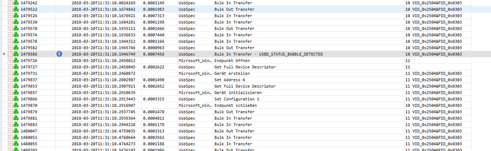

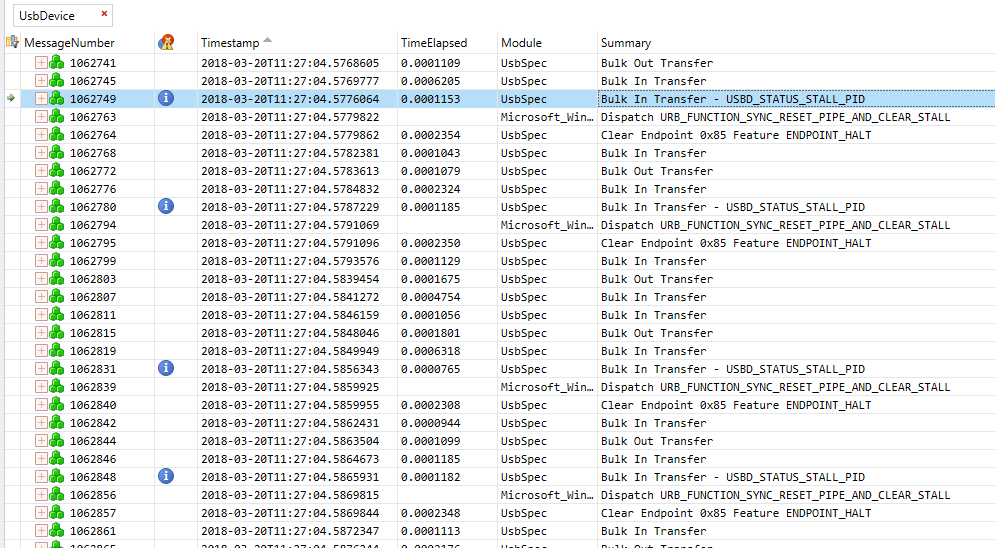

So, I actually manage to narrow the problem even more.
Using the demo application from the SDK 2.3, I get the same problem. The image below is using dev_composite_cdc_msc_freertos_frdmk82f with USB_DEVICE_CONFIG_USE_TASK set to 1, running on a FRDM-K82F board.
Every ~5min, the Status Babble is reported, the endpoint is closed and the Bus is Reset (one can see on the image above that every time the bus is reset, the host PC gives a new address to the device.
The exact same thing happened with the FRDM-K22F running the simpler demo from SDK 2.3 dev_msc_ramdisk_freertos_frdmk22f with USB_DEVICE_CONFIG_USE_TASK set to 0. The demo dev_msc_ramdisk_bm_frdm_frdmk22f presents the same problem.
Conclusion: this is a problem with the NXP's USB Stack and not my application.
To reproduce, just flash one of the MSD examples in a dev board and monitor the USB using Microsoft Message Analyzer. You'll see that the  device will receive a new address after one or two minutes of the enumeration and then every 5 min.
