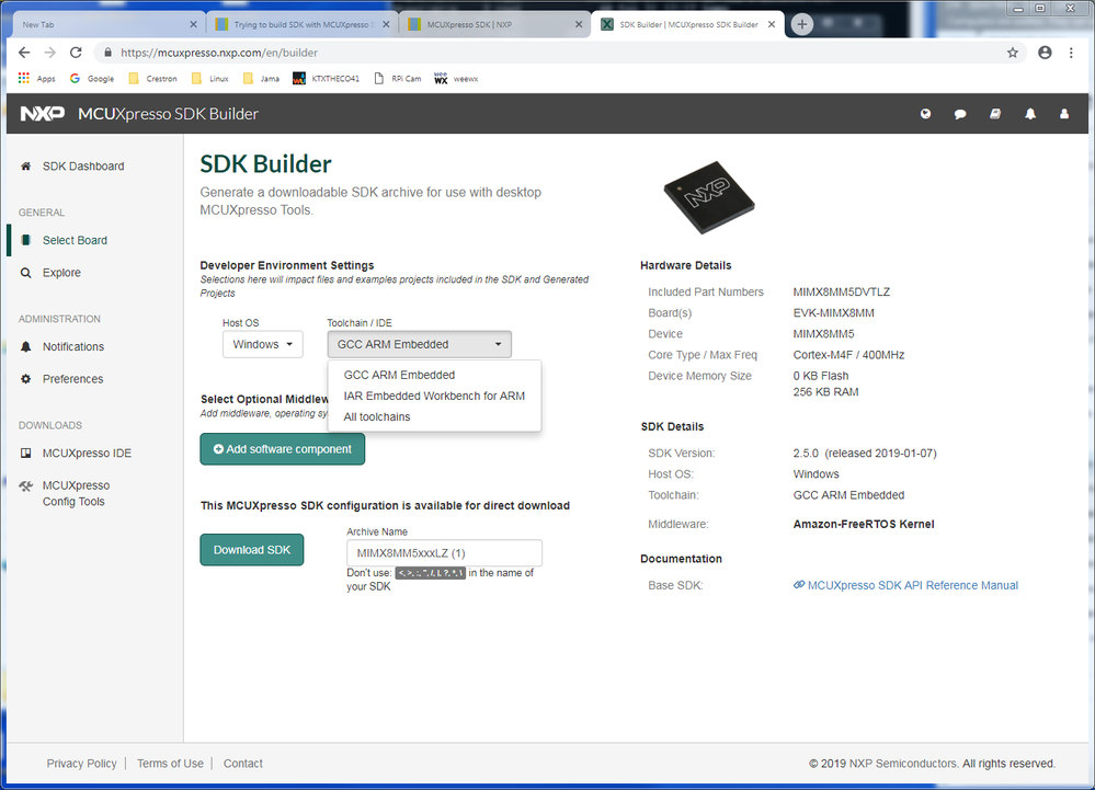

I've installed MCUXpresso IDE v10.3.1 [Build 2233] [2019-02-20]. I'm trying to get an SDK_2.5.0 for use with the iMX8MM for it. When I build an SDK for it, for the toolchain options it only shows GCC ARM and IAR Embedded (or all). It does not show MCUExpresso IDE as an option. How do I build a SDK that I can install into my MCUExpresso IDE?

Well, please note that MCUXpresso IDE is not supported by the SDK of i.MX8MM. (none of the i.MX8 SDKs variants are supported by MCUXpresso). It is just supported by IAR and GCC, so, please use those versions. The documentation and build options from the SDK Builder will be updated soon, please accept our apologies for any inconveniences about this.

petekockritz
Here's what I see for the Toolchain/IDE options in the SDK builder.
3,267 Views
petekockritz
When I build an SDK with 'all toolchains' and try to load it in MCUXpress, I get this error:
The SDK 'SDK_2.x_MIMX8MM5xxxLZ' does not contain any MCUXpresso IDE compatible toolchain
