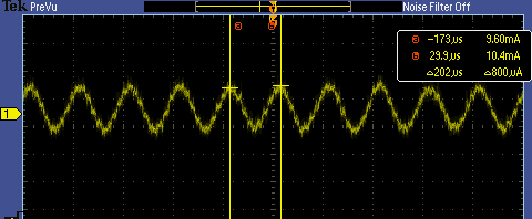

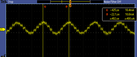

I took some screenshots of my findings so far:
Figure 1 attached is the sine wave output from your test. As you can see the Delta is 400us (2500Hz).Figure 1 - xiangjun_testFigure 1 - xiangjun_test
Figure 2 attached is the sine wave output from the DMA example. Delta 200us (5000Hz).Figure 2 - DMA_testFigure 2 - DMA_test
Figure 3 attached is the sine wave otuput from normal I2S without DMA. Delta 200us (5000Hz).Figure 3 - Non_DMA_testFigure 3 - Non_DMA_test
In figure 1, doubling the data as you suggested the sine wave lasted 3 seconds, however the freq. is half of what is expected.
in figure 2, DMA test, the frequency of the sine wave is correct, however it only last 1.5 seconds.
in figure 3, without DMA, the test lasts 3 seconds and the output is as expected.
All of these tests are carried out with the same I2S configuration and clock speeds. But it appears that the DMA is somehow mishandling the data input.
