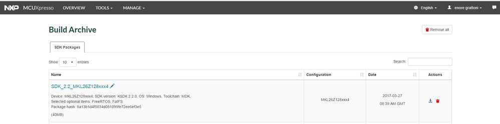

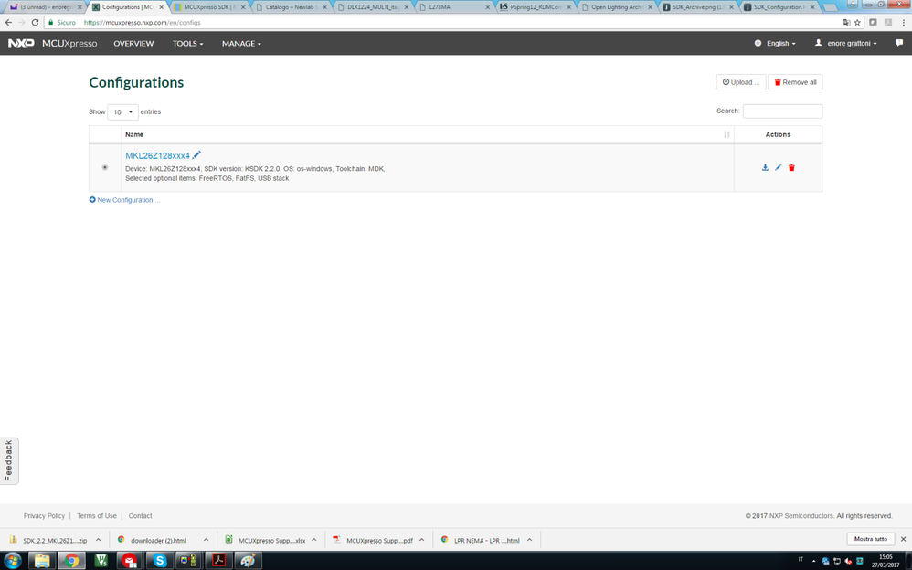

enore_grattoni
I see that USB stack is not selected on download
this is config
now I will try to reset config and download again
