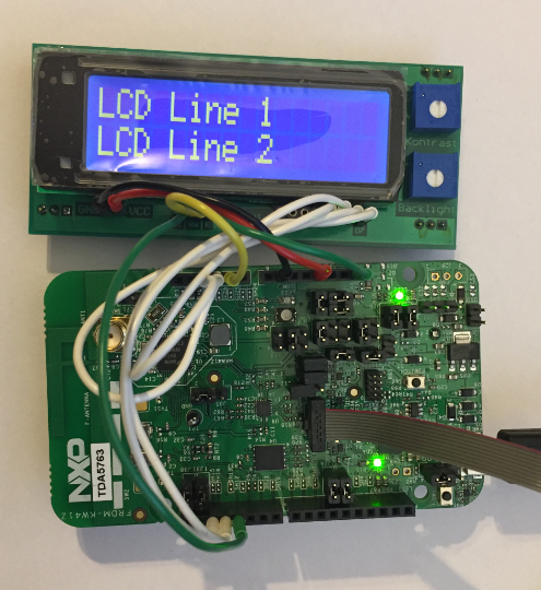

steve9
Thanks Erich. That's very kind of you!
The project built OK and downloaded to my board with no errors and the RGB LED is flashing on/off green. I haven't quite worked out all the connections between the KW41Z and the LCD, though. The way the code was generated doesn't make it clear which pins are mapped onto RS, E, D4-7. The photo helps but not quite enough! Any chance you could provide the pinout?
Hopefully you'll find another use for the board anyway. With best wishes.
Steve

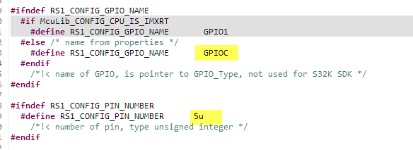

BlackNight
Hi Steve,
I used the MCUXpresso Pins tool to configure the pins, so you see all the pin assignment in the pins tool (see Tutorial: Muxing with the New NXP Pins Tool | MCU on Eclipse  if you are not familiar with it).
On top of that: the pins are configured in the *.config.h header files. You find them in the McuLib\HD44780 folder (they will be moved to the McuLib/config folder in a next version I'm working on ).
For example I have the RS pin on GPIOC, pin 5:
I hope this helps,
Erich

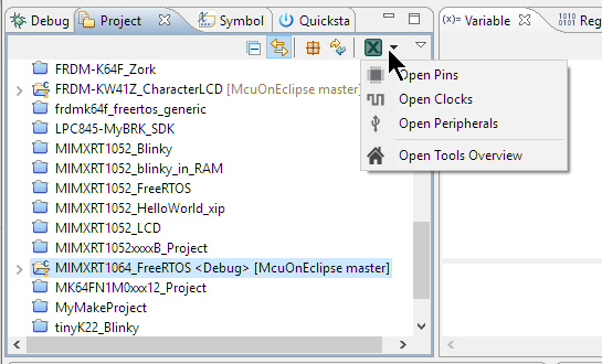

steve9
My error with the Pins tool was not realising that by default, it had opened the Pins configuration for a different project (from the last time I had used Pins). On my laptop, the little drop-down menu at the top (to choose which Eclipse project to configure) was almost hidden and only the first few characters of the project name were visible.
7,246 Views
BlackNight
It sounds like you did not use the version integrated in the MCUXpresso IDE? Because this one really makes it easy as it knows the project I'm working on.
7,246 Views
steve9
I'm using MCUX 10.3 with the integrated Pins tool. I open the Pins tool and select Project A, and make some settings for Project A. Then I decide to work on Project B so I go back to the Develop perspective and click on Project B and open some files. Then I decide to look at the Pins settings for Project B so I click on the Quick Access button to open the Pins perspective again but the Pins perspective still shows the Pins settings for Project A. There is a little drop-down near the top left of the screen to select the project for the Pins tool, but I didn't notice this at first. My mistake but, on my laptop, the little dropdown is small and if the project names are similar, it's easy to miss.
7,246 Views
BlackNight
Ok, I see now what you mean.
I did not had that because I usually use the small drop down in the Project Explorer view:
7,246 Views

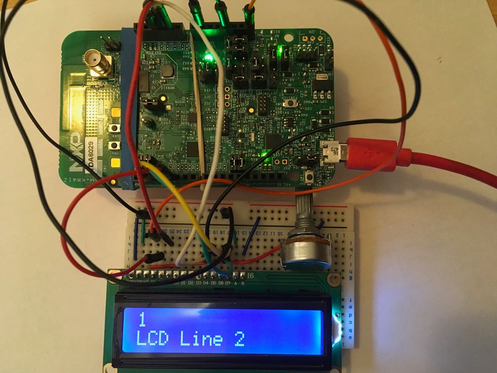

steve9
Hi Erich
It's very nearly working. Just missing the first 9 characters of Line 1. Any ideas?
7,246 Views
BlackNight
Are you sending the "LCD Line 1", but only get "1"? It might be that there is an extra delay needed. Does it work if you step over it with the debugger?
