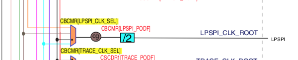

Hi Jack,
You could take a look to the i.MX RT Clock tree on figures 18-2 and 18-3 of the i.MXRT1050 Reference Manual:
https://www.nxp.com/docs/en/reference-manual/IMXRT1050RM.pdf
Hope this will be useful for you.
Best regards!
/Carlos

Carlos,
The reference manual is what I have been using already.
Specifically Figure 18-2.
This diagram shows Usb1PllPfd0Clk should be 720 MHz, in my case it maxes at 432MHz with:
CLOCK_InitUsb1Pfd(kCLOCK_Pfd0, 1);
Then the LPSPI clock select (kCLOCK_LpspiMux) chooses the clock source, and the clock divider (kCLOCK_LpspiDiv) feeds the baudrate calculation. Set with:
/* Select USB1 PLL PFD0 (720 MHz) as lpspi clock source */
#define EXAMPLE_LPSPI_CLOCK_SOURCE_SELECT (1U)
/* Clock divider for master lpspi clock source */
#define EXAMPLE_LPSPI_CLOCK_SOURCE_DIVIDER (0U)
CLOCK_DisableClock(kCLOCK_Lpspi3);
CLOCK_SetMux(kCLOCK_LpspiMux, EXAMPLE_LPSPI_CLOCK_SOURCE_SELECT);
CLOCK_SetDiv(kCLOCK_LpspiDiv, EXAMPLE_LPSPI_CLOCK_SOURCE_DIVIDER);
CLOCK_EnableClock(kCLOCK_Lpspi3);
Even then, the optimum baudrate calculation is not actually manifested in the SCK signal being generated.
Set with LPSPI_MasterSetBaudRate during the LPSPI init.

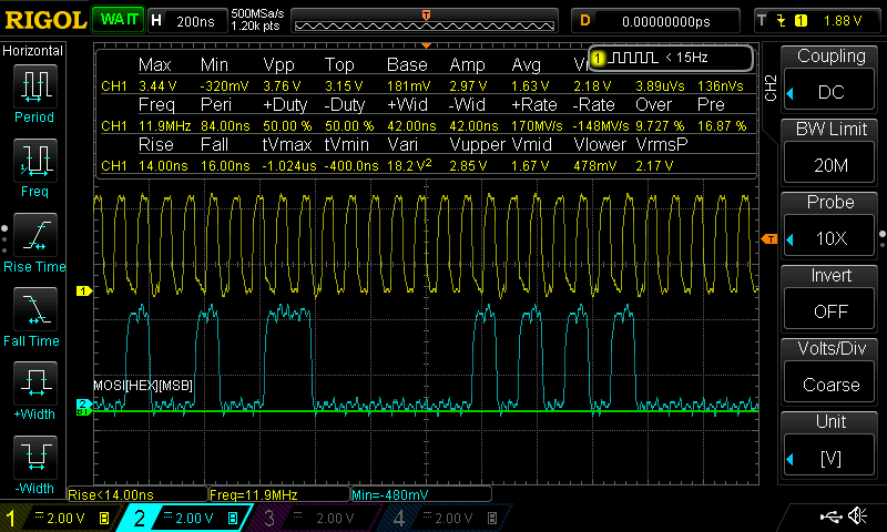

I still have had no luck getting SPI above 12MHz, even when it looks like it should be running at 27MHz based on the baudrate selected from a requested 36MHz rate.  I must be missing something that is limiting the SCK.
Here are the relevant settings I am using:
#define EXAMPLE_LPSPI_CLOCK_FREQ (CLOCK_GetFreq(kCLOCK_Usb1PllPfd0Clk) / (EXAMPLE_LPSPI_CLOCK_SOURCE_DIVIDER + 1U))
#define EXAMPLE_LPSPI_MASTER_CLOCK_FREQ EXAMPLE_LPSPI_CLOCK_FREQ
#define EXAMPLE_LPSPI_MASTER_BASEADDR (LPSPI3)
#define TRANSFER_BAUDRATE (36000000U)
PRINTF("clk: %d\n", CLOCK_GetFreq(kCLOCK_Usb1PllPfd0Clk));
/*Set clock source for LPSPI*/
CLOCK_InitUsb1Pfd(kCLOCK_Pfd0, 8);
PRINTF("aclk: %d\n", CLOCK_GetFreq(kCLOCK_Usb1PllPfd0Clk));
PRINTF("aspi: %d\n",(CLOCK_GetFreq(kCLOCK_Usb1PllPfd0Clk)/ (EXAMPLE_LPSPI_CLOCK_SOURCE_DIVIDER + 1U)));
/*Master config*/
    masterConfig.baudRate = TRANSFER_BAUDRATE;
    masterConfig.bitsPerFrame = 9;
    masterConfig.cpol = kLPSPI_ClockPolarityActiveHigh;
    masterConfig.cpha = kLPSPI_ClockPhaseFirstEdge;
    masterConfig.direction = kLPSPI_MsbFirst;
    masterConfig.pcsToSckDelayInNanoSec = 1000000000 / masterConfig.baudRate;
    masterConfig.lastSckToPcsDelayInNanoSec = 1000000000 / masterConfig.baudRate;
    masterConfig.betweenTransferDelayInNanoSec = 1000000000 / masterConfig.baudRate;
    masterConfig.whichPcs = EXAMPLE_LPSPI_MASTER_PCS_FOR_INIT;
    masterConfig.pcsActiveHighOrLow = kLPSPI_PcsActiveLow;
    masterConfig.pinCfg = kLPSPI_SdiInSdoOut;
    masterConfig.dataOutConfig = kLpspiDataOutRetained;
    LPSPI_MasterInit(EXAMPLE_LPSPI_MASTER_BASEADDR, &masterConfig, EXAMPLE_LPSPI_MASTER_CLOCK_FREQ);
This outputs:
clk: 36000000
aclk: 54000000
aspi: 54000000
best LPSPI PRESCALE: 0
best LPSPI SCKDIV: 0
best LPSPI baudrate: 27000000
Looking at the actual SCK on the scope, it maxes out at 12MHz:
4,071 Views
