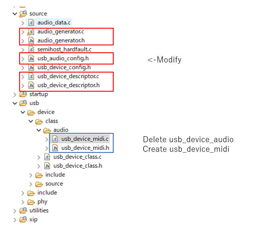

ogawatakeshi
Hello
A simple example is implemented using MCUXpresso USB Stack.
Referenced projects(dev_audio_generator_bm)
modify following code
Please refer to the following article
MCUXpressoSDK USB StackでMIDIStreamingSubClassを使う2 - がれすたさんのDIY日記
(Sorry in japanese......
