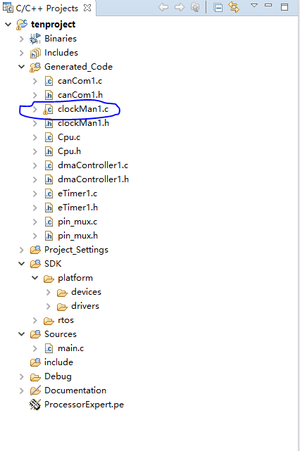

When I use SDK(S32_SDK_EAR_0.8.2) for 5744P, I met some questions.

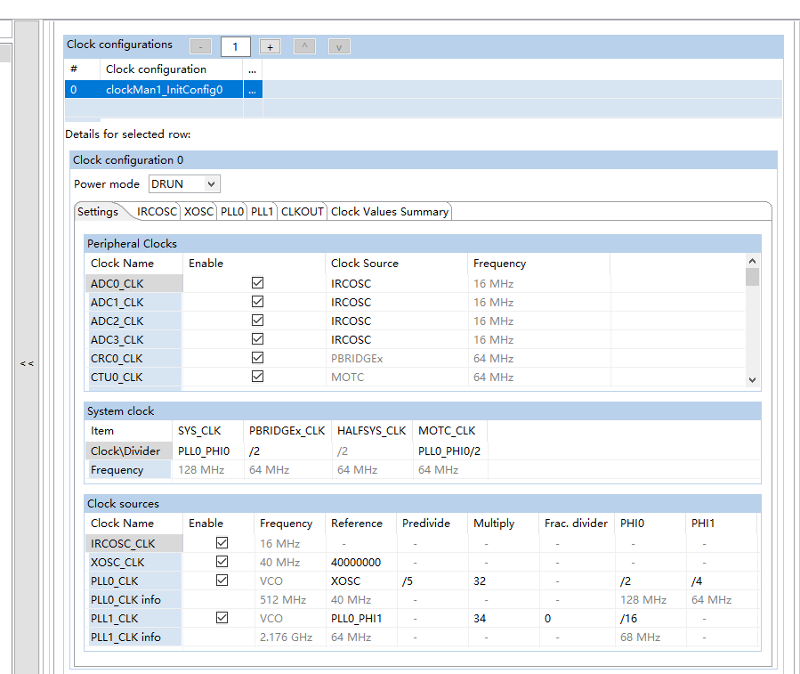

1. I use the graphical https://community.nxp.com/discussion/?keyword=" style="color: #4285cc; text-decoration: none;interfaces to build a driver clock project, I found the graphical https://community.nxp.com/discussion/?keyword=" style="color: #4285cc; text-decoration: none;interfaces is very useful.
    but I don't know how to use the project.
2. For example, when I had already finish configured the  graphical https://community.nxp.com/discussion/?keyword=" style="color: #4285cc; text-decoration: none;interfaces for Clock.And I can see the clockMan1.c has changed.
    but I don’t know how to use the clockMan1.c . Could you tell me how to use the  .C  file or give a example project based on 5744P SDK
  for me. If you can,please send it to my email(15313423705@163.com). Thank you very much.

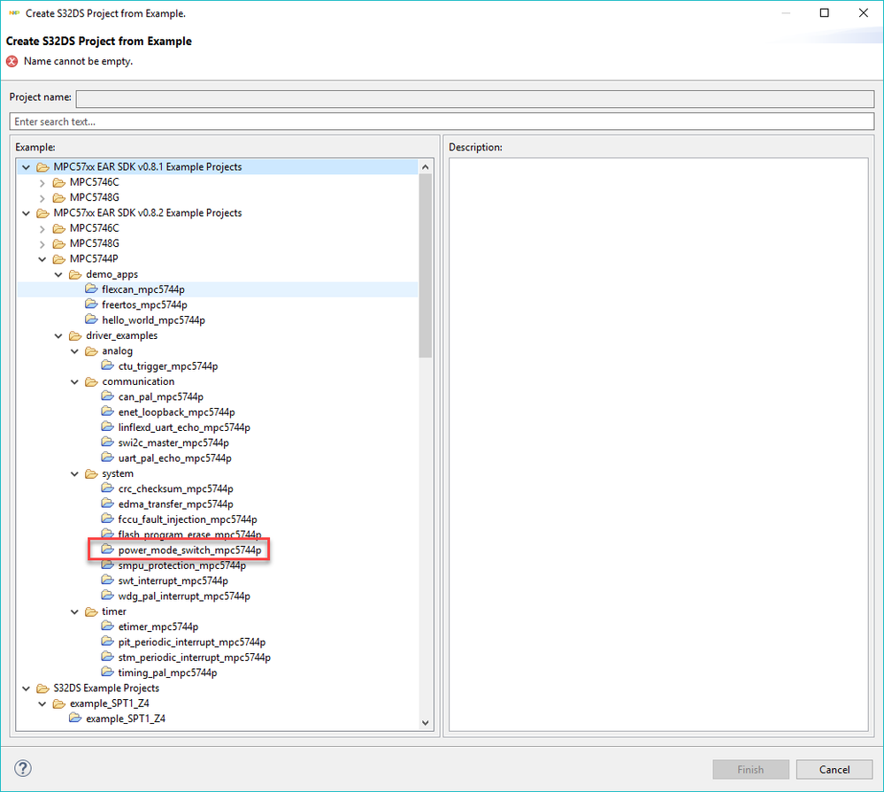

there is example directly is S32DS, which shows, how to work with clock manager. Please check the figure below and in case you have any questions, please feel free to write me back.
Martin
