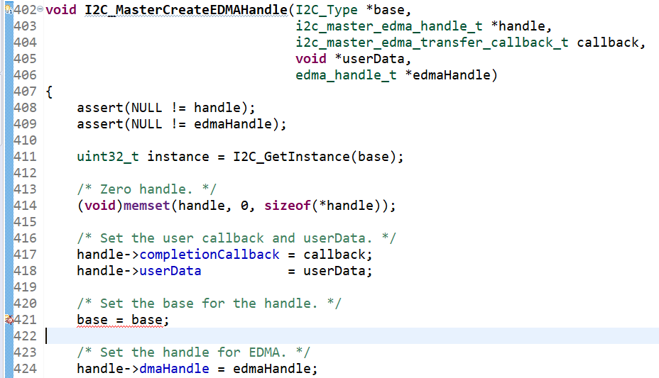

Using K64F, SDK 2.8, apparent bug in fsl_i2c_edma.c version 2.08.
Found by running Eclipse built-in code analysis on my project; note error below:
Line 421 is clearly wrong but I don't know what it SHOULD be.
Perhaps NXP should also use static analysis tools...
Please confirm this bug and provide a solution,
Best Regards, Dave

@danielchen- Can you please confirm:
- the responsible developer has reviewed the code and recommended to simply remove the line with no other changes.
Thanks!
Best Regards, Dave
2,857 Views
danielchen
Yes.

@danielchen- "Seems redundant" is not a great answer.
Don't you think it would be best to check with the developer what was intended here?
Best Regards, Dave
2,871 Views
danielchen
Hi @davenadler
This redundant line is introduced unexpectedly.  Will remove this code. Sorry for the inconvenience.

danielchen
Hi Dave:
Thanks for your feedback.  It seems a redundant line. Because base is reassigned to
s_i2cEdmaPrivateHandle[instance].base in following line.
 /* Set the base for the handle. */
    base = base;
    /* Set the handle for EDMA. */
    handle->dmaHandle = edmaHandle;
    s_i2cEdmaPrivateHandle[instance].base   = base;
    s_i2cEdmaPrivateHandle[instance].handle = handle;
