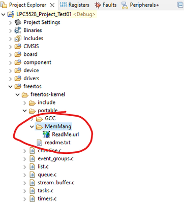

danielholala
Senior Contributor II
Dear @RaRo ,
just figured that no FreeRTOS memory managers are added to the project (although FreeRTOS has been selected as SDK component for "operating system").
As you know, for FreeRTOS based projects all of the required FreeRTOS files reside in subfolder freertos. However, the five different implementations of memory managers are missing. They should appear in the subfolder "MemMang" but this folder is effectively empty:
Can you reproduce this issue?
4,236 Views
RaRo
Hello @danielholala,
Thanks for telling us about this detail.
We could reproduce it in our side. This seems to happen while creating a New Project. In FreeRTOS examples, the MemMang subfolder includes heap4.c. Let us report this issue to the team in charge.
Thanks again for the feedback.
Best regards, Raul.

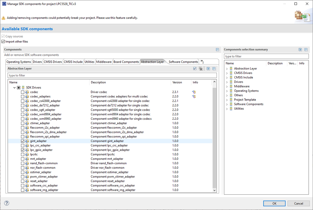

While we are at it, I'd like to point out that the dependency issue is not limited to FreeRTOS component.
For example, this selection also generates a project that does not compile:
I have no idea what "gint_adapter" and "lpc_gpio_adapter" do as there is no documentation on them but the project does not compile when both components are included.
4,242 Views
RaRo
In this particular case, as you select both gint_adapter and lpc_gpio_adapter, there are some redefinitions which causes the compilation to fail. You might want to use only one of them to avoid getting compilation errors.
As you mentioned, not all the SDK code have documentation. Unfortunately, there is not a document for the abstraction layer. In this case we recommend you check the source code directly.
In any case, this issue has been reported before to team in charge as mentioned here: Solved: SDK Software component and abstraction layer docum... - NXP Community.
Let us know, if we can help with some other compilation errors.
Best regards, Raul.
