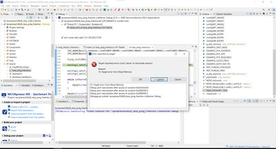

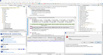

Hello I have a issues with the
SDK_2_.x_LPC54008J512 2.13 MCUXpresso IDE v11.7.1_9221
SDK_2_.x_LPC54008J512 12.14 MCUXpresso IDE v11.8.0_1165
The testboard is the lpcxpresso54628 eval brd rev e.
Some LWIP examples doesn’t work.
lpcxpresso54628_lwip_ping_freertos
lpcxpresso54628_lwip_httpsrv_freertos.
They crash when reach the breakpoint in stack_init(
I only import the examples buld and start the debugibg. I didn’t make any change.
See pictures.
It seems that the linker link some functions to external ram. o_0 Add: 0xA5A5A5A4.
The example lpcxpresso54628_lwip_dhcp_freertos doesn’t crash on breakpoint in stack_init(.
Quick test with MCUXpresso IDE v11.5.1_7266 and SDK 2.7.0 shows that the lpcxpresso54628_lwip_ping_freertos there works fine.
Is this a bug or a wrong setting?
I would be grateful for a solution.

Like NXP recommend I’ve made the update from the SDK. I’ve made an update of my project from V2.7 to V2.13 (fsl stuff, phy and lwip) and now its hangs in the enet software reset function. DMA mode register Software reset Bit stays ‘1’.
The v2.7 was working out of the box. There was no need to go deep in it. Now I need to understand the initialization to fix it. That’s why the break point is there.
Even when the Break point is set in stack_init(picture). RTOS execute in external ram! But there is no init for external RAM PINs or a call of BOARD_InitSDRAM(void); I made a test and comment BOARD_InitSDRAM out…
So where is the init for external ram if the use of external ram is not a bug? Why its paced in the external ram? lpc54xxx cann not set a break point there but rtos is executed there. So, for debugging is almost useless…

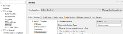

Sorry for the delay. Could you please do the following changes to the project?
  • Change #define configENABLE_BACKWARD_COMPATIBILITY to 1 in FreeRTOSConfig.h
  • Right click on your project, go to Properties -> C/C++ Build -> Settings -> MCU C Compiler -> Optimization. There please change the Optimization Level to None (-O0).
RaulRomero_0-1693846819266.png[Properties- > C/C++ Build -> Settings -> Optimization]
We made it work in our side with an LPCXpresso546xx Rev D and the SDK_2.14_LPCXpresso54628.
Once again, we apologize for the delay. Let us know if the setting mentioned work on your side.
Best regards, Raul.
3,641 Views
A_M
Hello Raul,
it was enough to set the debug setting to None (-O0).
It worked regardless of how configENABLE_BACKWARD_COMPATIBILITY 0/1 was set.
It seems to be a compiler problem.
Best regards, Alex.
