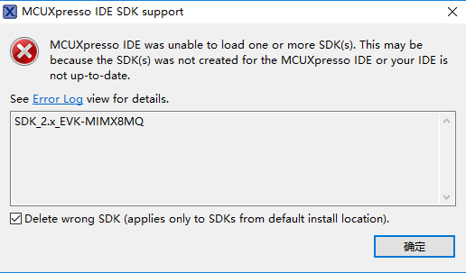

Dear All,
I can't install "SDK_2.x_EVK-MIMX8MQ" to MUCXpresso IDE.
thanks!

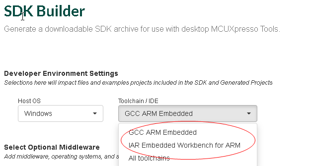

Hello liu liang,
Sorry the SDK for EVK-MIMX8MQ doesn't support MUCpresso IDE,
only support GCC ARM Embedded and IAR Embedded, when download SDK we can choose :
https://mcuxpresso.nxp.com/en/builder
