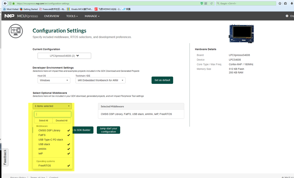

From SDK_2.2_LPCXpresso54608.zip, document "MCUXpresso SDK Release Notes_LPC546xx.pdf" indicates :
      emWin examples <install_dir>/boards/<board_name>/emwin_examples.
      RTOS examples <install_dir>/boards/<board_name>/rtos_examples.
But I cannot find emwin_examples nor rtos_examples in "<install_dir>/boards/lpcxpresso54608".
Is there are another SDK including it or they are not available for lpcxpresso54608 ?
Thanks for your help !
1,784 Views
kerryzhou
Hi Jean-Marc,
   I think your problem is the SDK download problem.
   When you download the code, you need to select the emwin and FreeRTOS, in default, it is not select.
  Please go to:
Welcome to MCUXpresso | MCUXpresso Config Tools
Configure it like this:
Then download the code again, you will find the emwin and rtos code in the according folder.
Kerry

Jean_Marc
Hi Kerry,
Oh ok, I've firstly downloaded it form the main page so there was only the default one. Now I got it from the Config Tool page as you said and I've got emwin and rtos.
