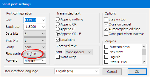

I had the same problem (sending the first character was ok, everything else afterwards was blocking the terminal) with the MCUXpresso SDK V2.2 for the FRDM-K22F board.
After poking around, I have found the solution: I had to configure the terminal connection to use flow control with RTS/CTS:
Then it worked.
I hope this helps everyone else,
Erich

I have not checked it, but I think there must be an attribute or someting in the descriptor forcing that flow control. From other USB CDC implementations (e.g. NXP USB Stack 4.x) flow control is not necessary.
Erich
