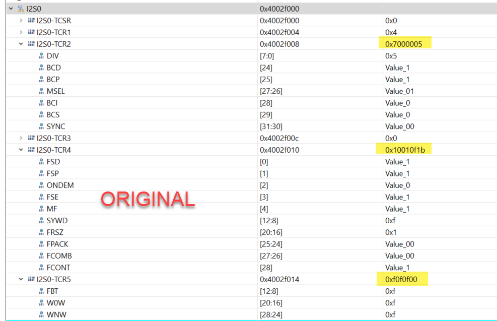

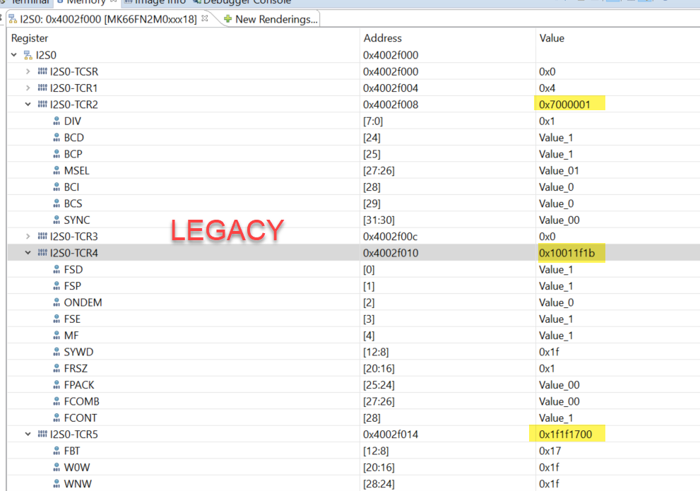

I am sorry for the late reply. We have been under a big workload. So far I have replicated your issue and realized that the classic APIs are not setting the same registers as the latest SDK APIs. Please check the below snippets.
I will still need to check which of these differences is making I2S not work. If you have time you could also help me to check this on your side.
Felipe

So just changing the the bitWidth & DEMO_AUDIO_BIT_WIDTH to 24 bits while keeping everything the same does indeed work. We get 24-bit samples at 16KHz just fine.
The issue is related to 48KHz sampling. When I change the demo program to 48KHz sample rate by changing the following:
#define OVER_SAMPLE_RATE (256U)
#define DEMO_AUDIO_SAMPLE_RATE (kSAI_SampleRate48KHz)
#define DEMO_AUDIO_BIT_WIDTH kSAI_WordWidth16bits
da7212_config_t da7212Config = {
    .i2cConfig    = {.codecI2CInstance = BOARD_CODEC_I2C_INSTANCE, .codecI2CSourceClock = 60000000},
    .dacSource    = kDA7212_DACSourceInputStream,
    .slaveAddress = DA7212_ADDRESS,
    .protocol     = kDA7212_BusI2S,
    .format       = {.mclk_HZ = 12288000U, .sampleRate = 48000, .bitWidth = 16},
    .isMaster     = false,
The application only works with 16-bit and 32-bit bit widths; 24-bit does not work, static is produced. However with the "legacy" configuration code, it does work with all valid bit widths (16, 24 and 32-bit).
Can you reproduce this issue?
I can confirm I am using SDK 2.7.0 and IDE 11.1.1.
Thank you for your continued assistance with this matter.
Sincerely,
Scott
