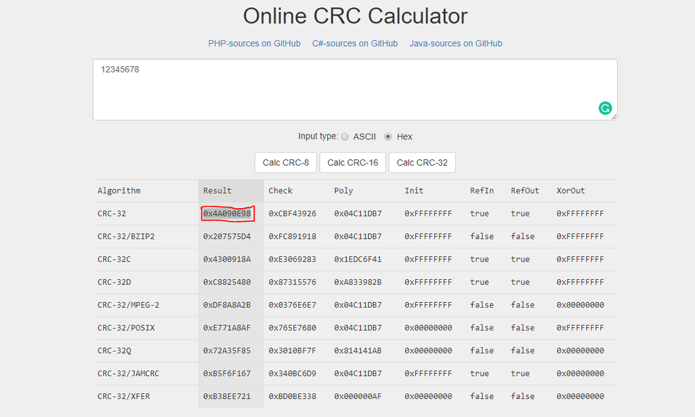

First off I am a beginner so I might be missing something here.
If you see something I am missing, please let me know because I am actively trying to learn.
I am starting to use CRC as well as the S32k148 SDK
I am having issues creating a configuration that is compatible with CRC 32 bit Ethernet or just common CRC 32 bit.
The polynomial for the CRC 32 I am talking about is  0x04C11DB7
I was successful in getting CRC 16 bit to work, however I am having issues with CRC 32 bit.
I notice when I have the default settings (no read/write transpose or XOR ) I get CRC 32 MPEG-2 rather then CRC-32 bit Ethernet.
The difference between them I found is that CRC-32 ethernet has a reflected in and reflected out data compared to MPEG-2. My assumption from the reading the data sheet is that this is the same as NXP's  transpose read and write.
Unfortunately when I implemented this it gave me a result that was incorrect.
Since I was at a lost, I try all the different parameters given to me (checksum  read/write transpose etc.) and no results were correct for the basic crc-32 bit for Ethernet.
Is there any other core function about CRC I am missing that it is not enabling me to get a basic 32 bit crc working?
I will have some of my code below.

Parameters I have tried.
Tool I am using to determine accuracy.
https://crccalc.com/
Thank you for help
Andrew.
