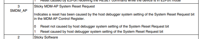

Alexis_A
Dear Francesco,
Checking this registers I found one strange things. In the SSRS1 the SMDM_AP bit is enabled.
This says that the debugger is causing a reset. If you desconect your debug this problem is still present?
Also, do you have one of our developments boards? I would like to know if you can replicate this issue with one of our boards.
