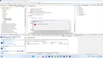

 In my program it says binary not found while running the code

It looks you have not compiled/linked your project. I don't see a 'Debug' folder in your screenshot, so did you build the project? Use the 'hammer' icon to build it.
The message is telling your that you don't have a binary (or elf/dwarf file) to debug.
